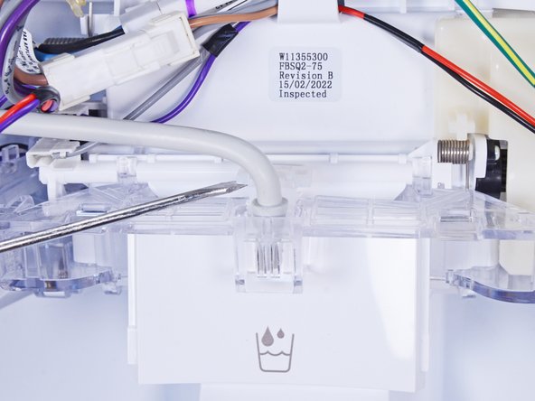

  9. WRS315SDHW Dispenser Assembly Replacement, Remove the plastic clip: crwdns2935265:09crwdnd2935265:01crwdnd2935265:03crwdne2935265:0 WRS315SDHW Dispenser Assembly Replacement, Remove the plastic clip: crwdns2935265:09crwdnd2935265:02crwdnd2935265:03crwdne2935265:0 WRS315SDHW Dispenser Assembly Replacement, Remove the plastic clip: crwdns2935265:09crwdnd2935265:03crwdnd2935265:03crwdne2935265:0
    • Use a flathead screwdriver, or a similar tool, to pry up the plastic clip securing the water hose.
    • Remove the plastic clip.
  10. WRS315SDHW Dispenser Assembly Replacement, Disconnect the water hose: crwdns2935265:010crwdnd2935265:01crwdnd2935265:03crwdne2935265:0 WRS315SDHW Dispenser Assembly Replacement, Disconnect the water hose: crwdns2935265:010crwdnd2935265:02crwdnd2935265:03crwdne2935265:0 WRS315SDHW Dispenser Assembly Replacement, Disconnect the water hose: crwdns2935265:010crwdnd2935265:03crwdnd2935265:03crwdne2935265:0
    • Use a flathead screwdriver, or a similar tool, to pry up the water hose enough to grip it with your fingers.
    • Pull the water hose straight up to disconnect it.

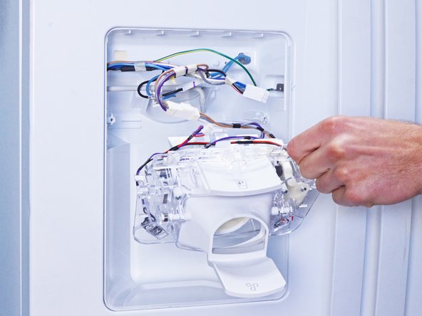

  13. WRS315SDHW Dispenser Assembly Replacement, Reposition the dispenser assembly: crwdns2935265:013crwdnd2935265:01crwdnd2935265:03crwdne2935265:0 WRS315SDHW Dispenser Assembly Replacement, Reposition the dispenser assembly: crwdns2935265:013crwdnd2935265:02crwdnd2935265:03crwdne2935265:0 WRS315SDHW Dispenser Assembly Replacement, Reposition the dispenser assembly: crwdns2935265:013crwdnd2935265:03crwdnd2935265:03crwdne2935265:0
    • Pull the dispenser assembly away from the chassis enough to access its connectors.
  14. WRS315SDHW Dispenser Assembly Replacement, Disconnect the dispenser assembly: crwdns2935265:014crwdnd2935265:01crwdnd2935265:03crwdne2935265:0 WRS315SDHW Dispenser Assembly Replacement, Disconnect the dispenser assembly: crwdns2935265:014crwdnd2935265:02crwdnd2935265:03crwdne2935265:0 WRS315SDHW Dispenser Assembly Replacement, Disconnect the dispenser assembly: crwdns2935265:014crwdnd2935265:03crwdnd2935265:03crwdne2935265:0
    • While performing this step, support the dispenser assembly so it doesn't fall.
    • Disconnect the connector attached to the dispenser assembly.
  15. WRS315SDHW Dispenser Assembly Replacement, Remove the dispenser assembly: crwdns2935265:015crwdnd2935265:01crwdnd2935265:01crwdne2935265:0
    • Remove the dispenser assembly.
