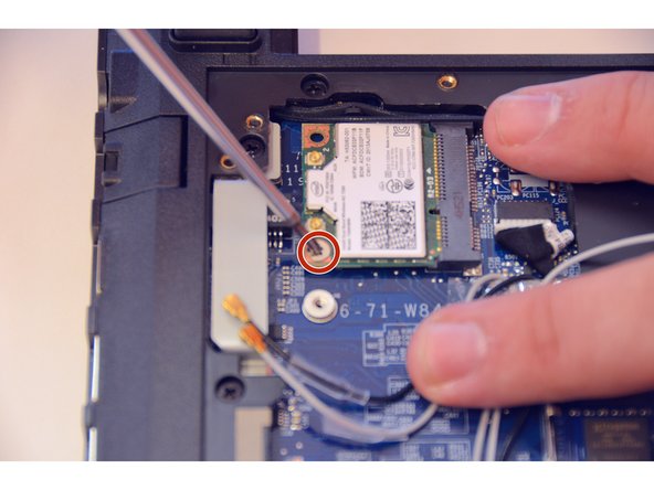

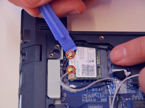

  4. WLAN / Bluetooth Card Replacement, WLAN / Bluetooth card: crwdns2935265:04crwdnd2935265:01crwdnd2935265:03crwdne2935265:0 WLAN / Bluetooth Card Replacement, WLAN / Bluetooth card: crwdns2935265:04crwdnd2935265:02crwdnd2935265:03crwdne2935265:0 WLAN / Bluetooth Card Replacement, WLAN / Bluetooth card: crwdns2935265:04crwdnd2935265:03crwdnd2935265:03crwdne2935265:0
    • Here is the WLAN Chipset / Bluetooth
    • Gently unplug the MAIN and AUX antennas.
    • Unscrew the fixing screw with Philips # 0 screwdriver.
  5. WLAN / Bluetooth Card Replacement: crwdns2935265:05crwdnd2935265:01crwdnd2935265:02crwdne2935265:0 WLAN / Bluetooth Card Replacement: crwdns2935265:05crwdnd2935265:02crwdnd2935265:02crwdne2935265:0
    • Slightly lift the chipset and remove it from the mSATA connector.
    • Here is the chipset outside of its location.
