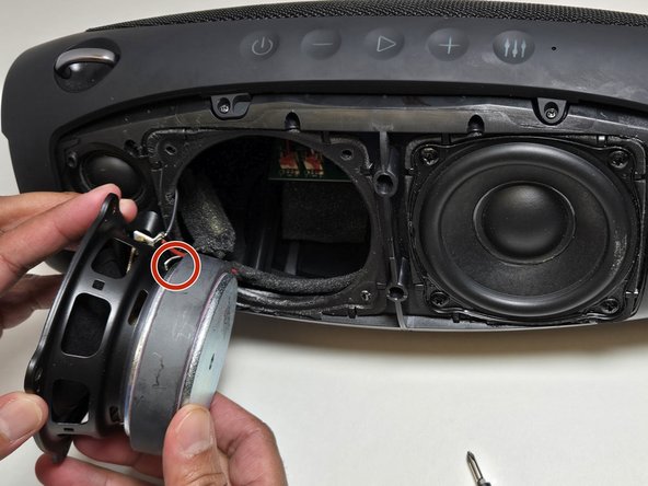

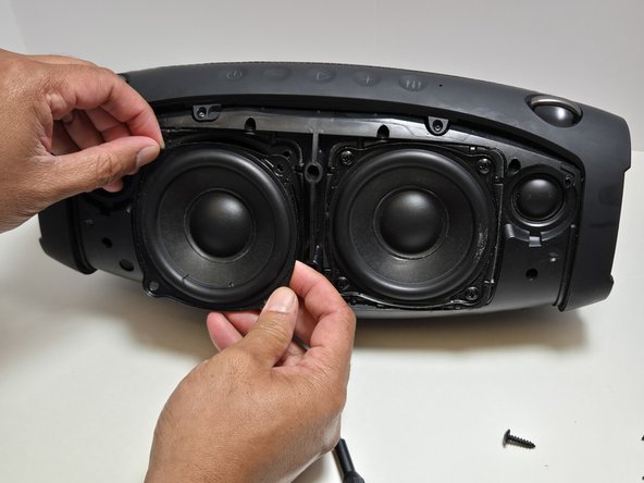

    • Use a Phillips #2 screwdriver to remove four 15.5 mm screws from the corners of each speaker.
  6. W-King X10 Tweeter Replacement: crwdns2935265:06crwdnd2935265:01crwdnd2935265:02crwdne2935265:0 W-King X10 Tweeter Replacement: crwdns2935265:06crwdnd2935265:02crwdnd2935265:02crwdne2935265:0
    • Gently pull the speaker straight out of the frame of the device.
    • If you tilt the speaker too far, it may catch on the frame, making it impossible to remove.
    • The speakers are connected to the board by cables, so avoid yanking or pulling on them forcefully.
  7. W-King X10 Tweeter Replacement: crwdns2935265:07crwdnd2935265:01crwdnd2935265:02crwdne2935265:0 W-King X10 Tweeter Replacement: crwdns2935265:07crwdnd2935265:02crwdnd2935265:02crwdne2935265:0
    • Use a soldering iron to disconnect the three wires connecting the speaker to the motherboard.

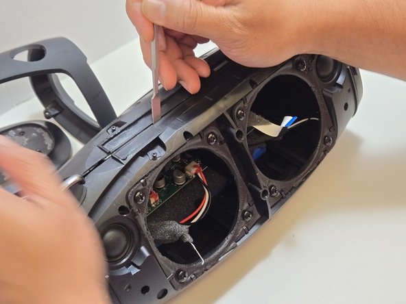

    • Remove the Control Panel from the top of the X10 by using the plastic spudger to separate the glue that attaches it to the casing.
    • There will be limited slack on the panel until you disconnect the ribbon cable. Be careful to not overexert the cable by keeping the panel close to the casing until you have disconnected the cable.
    • Using a pair of tweezers, gently pry the ribbon cable that connects the control panel to the motherboard.

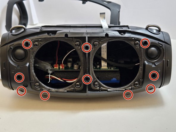

    • Use a 2.5 millimeter hex key to remove the ten 17.5 mm screws that connect the two halves of the X10 casing.
    • Several of these hex screws are in deep, narrow holes in the casing. We recommend using a full-length hex key rather than a hex bit at the end of a driver.
    • Separate the two halves of the casing using the metal spudger to pry apart the ten connection arms that form the structure of the casing.
    • If this is the first time opening the casing of this X10, there will be glue around the seam of the casing. Use the spudger to split the glue to loosen the seam.
