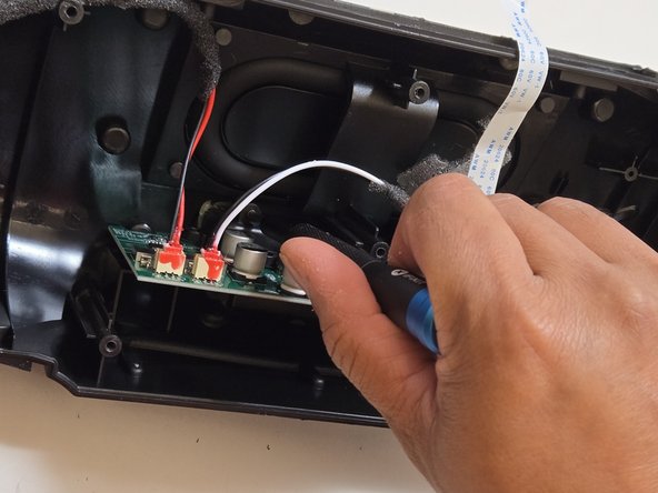

  15. W-King X10 Motherboard Replacement, Motherboard: crwdns2935265:015crwdnd2935265:01crwdnd2935265:02crwdne2935265:0 W-King X10 Motherboard Replacement, Motherboard: crwdns2935265:015crwdnd2935265:02crwdnd2935265:02crwdne2935265:0
    • Use a Phillips #0 screwdriver to remove the four 7.5 mm screws connecting the casing motherboard to the case.
  16. W-King X10 Motherboard Replacement: crwdns2935265:016crwdnd2935265:01crwdnd2935265:02crwdne2935265:0 W-King X10 Motherboard Replacement: crwdns2935265:016crwdnd2935265:02crwdnd2935265:02crwdne2935265:0

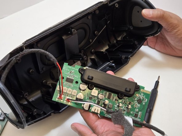

    • Remove the motherboard from the X10 by pulling it straight out of the case.
    • To prevent damage to the motherboard, grip the plastic case attachment rather than the motherboard itself.

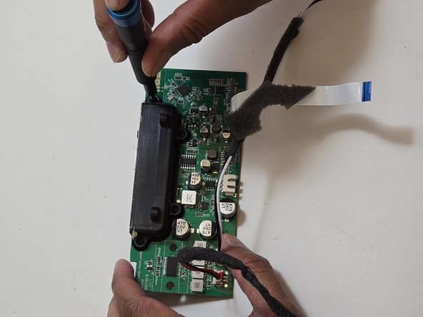

  17. W-King X10 Motherboard Replacement: crwdns2935265:017crwdnd2935265:01crwdnd2935265:02crwdne2935265:0 W-King X10 Motherboard Replacement: crwdns2935265:017crwdnd2935265:02crwdnd2935265:02crwdne2935265:0
    • Use a Phillips #0 screwdriver to remove the four 11.5 mm screws connecting the black attachment to the motherboard.
