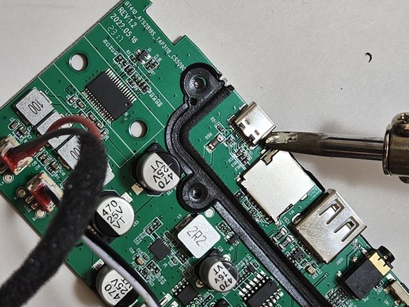

  18. W-King X10 Charging Port Replacement, Charging Port: crwdns2935265:018crwdnd2935265:01crwdnd2935265:01crwdne2935265:0
    • Locate the USB-C Charging Port connection on the motherboard.
  19. W-King X10 Charging Port Replacement: crwdns2935265:019crwdnd2935265:01crwdnd2935265:02crwdne2935265:0 W-King X10 Charging Port Replacement: crwdns2935265:019crwdnd2935265:02crwdnd2935265:02crwdne2935265:0
    • Use a soldering iron to desolder the four connection points attaching the charging port to the motherboard.
    • Soldering irons operate at extremely high temperatures. Be careful to avoid burning yourself, others, or damaging your belongings.
  20. W-King X10 Charging Port Replacement: crwdns2935265:020crwdnd2935265:01crwdnd2935265:01crwdne2935265:0
    • Use tweezers to remove the charging port from the motherboard.
    • This must be done before any of the solder in the connection points has a chance to re-solidify.
