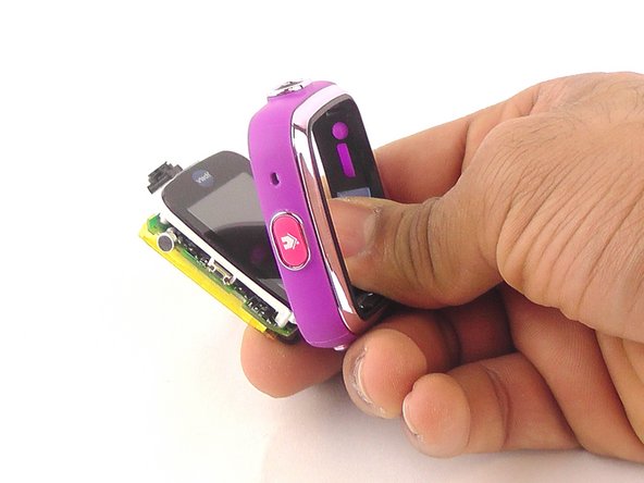

  5. Vtech Kidizoom Smart Watch DX Circuit Board Replacement, Circuit Board: crwdns2935265:05crwdnd2935265:01crwdnd2935265:02crwdne2935265:0 Vtech Kidizoom Smart Watch DX Circuit Board Replacement, Circuit Board: crwdns2935265:05crwdnd2935265:02crwdnd2935265:02crwdne2935265:0
    • The speaker wires are fragile. They may break if excessive force is used to remove the circuit board.
    • Removal of the circuit board requires soldering.
    • Gently push on the display from the front, near the camera. The circuit board and display will pop out through the back.
  6. Vtech Kidizoom Smart Watch DX Circuit Board Replacement: crwdns2935265:06crwdnd2935265:01crwdnd2935265:01crwdne2935265:0
    • Lift the circuit board carefully from the casing, without breaking or detaching the speaker wires at the bottom of the circuit board.
  7. Vtech Kidizoom Smart Watch DX Circuit Board Replacement: crwdns2935265:07crwdnd2935265:01crwdnd2935265:01crwdne2935265:0
    • Note which wire is connected to which lead before continuing. There are no markers on the circuit board to indicate where each wire belongs.
