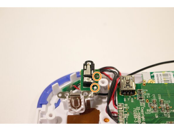

  5. Vtech InnoTab 3S Headphone Port Replacement, Headphone Port: crwdns2935265:05crwdnd2935265:01crwdnd2935265:03crwdne2935265:0 Vtech InnoTab 3S Headphone Port Replacement, Headphone Port: crwdns2935265:05crwdnd2935265:02crwdnd2935265:03crwdne2935265:0 Vtech InnoTab 3S Headphone Port Replacement, Headphone Port: crwdns2935265:05crwdnd2935265:03crwdnd2935265:03crwdne2935265:0
    • The headphone port is located towards the top left side of the device.

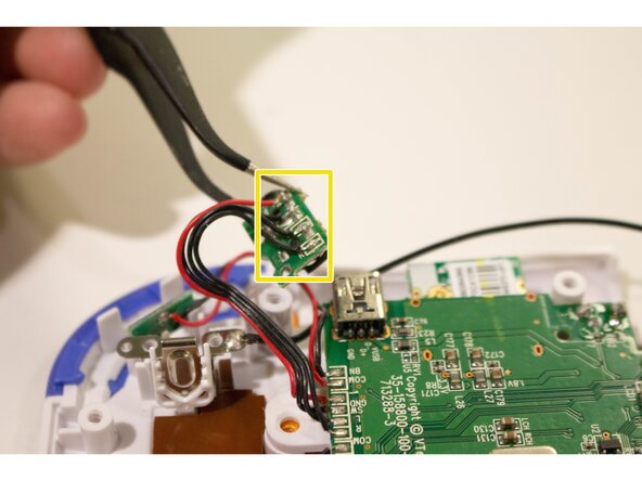

    • With tweezers remove the headphone port from its slot on the device.
    • The headphone port is fastened by two plastic poles. For easier removal lift the headphone port perpendicular to the device upwards.
    • Avoid damaging the plastic poles fastening the headphone port to the device. They are extremely fragile.
    • Desolder the wires securing the headphone port to the device.
    • Be careful when using a soldering iron as it gets extremely hot and will burn.
