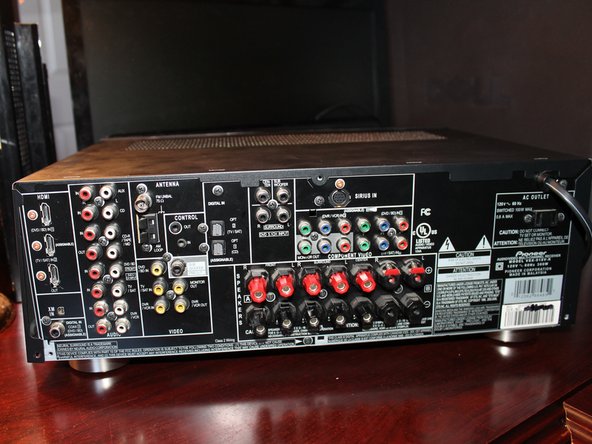

    1. Volume Control Potentiometer Cleaning, Unplug the receiver: crwdns2935265:01crwdnd2935265:01crwdnd2935265:01crwdne2935265:0
      • In order to ensure there is no residual power, unplug the receiver for 48-72 hours. This will drain the capacitors so it can be safely serviced.
      • Before working on the unit, disconnect the unit from the wall. Hold the power button in for 60 seconds to drain the capacitors.

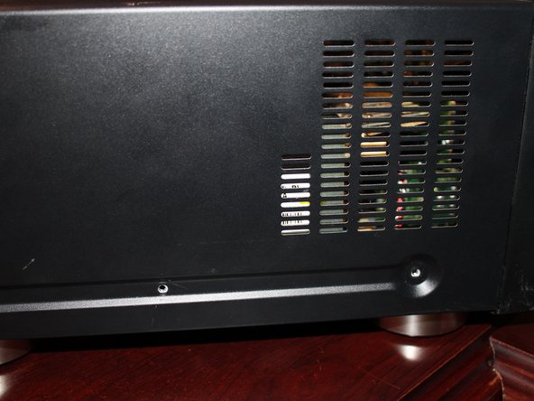

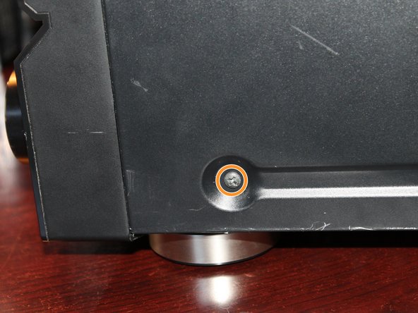

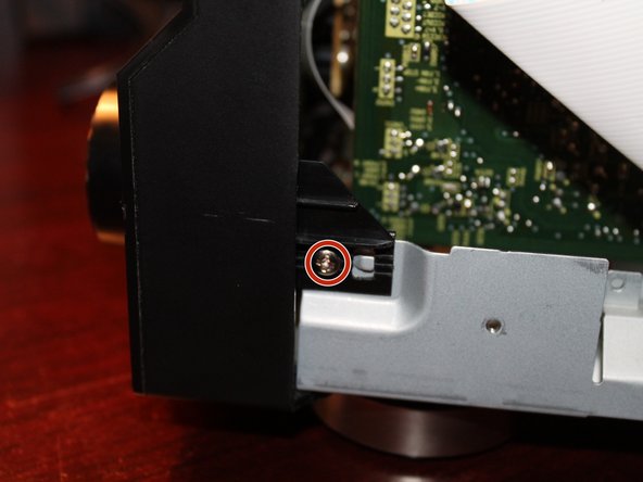

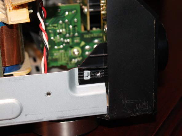

    3. Volume Control Potentiometer Cleaning, Remove the side panel screws: crwdns2935265:03crwdnd2935265:01crwdnd2935265:03crwdne2935265:0 Volume Control Potentiometer Cleaning, Remove the side panel screws: crwdns2935265:03crwdnd2935265:02crwdnd2935265:03crwdne2935265:0 Volume Control Potentiometer Cleaning, Remove the side panel screws: crwdns2935265:03crwdnd2935265:03crwdnd2935265:03crwdne2935265:0
      • Remove the 2 Phillips #2 screws from the left side of the receiver. They are the same length.
      • Remove the 1 screw on the right side of the receiver, it is the same bit size as the previous screws. While it appears to be the same, sort it separately.

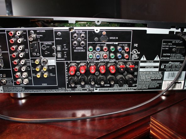

    4. Volume Control Potentiometer Cleaning, Remove the back screws: crwdns2935265:04crwdnd2935265:01crwdnd2935265:03crwdne2935265:0 Volume Control Potentiometer Cleaning, Remove the back screws: crwdns2935265:04crwdnd2935265:02crwdnd2935265:03crwdne2935265:0 Volume Control Potentiometer Cleaning, Remove the back screws: crwdns2935265:04crwdnd2935265:03crwdnd2935265:03crwdne2935265:0
      • Exercise extreme caution with the receiver at this point! You will not be protected from socks if you touch a charged component!
      • Remove the 3 Phillips #2 screws from the back of the receiver. Once these are removed, the cover will come off.

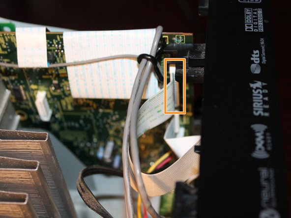

    8. Volume Control Potentiometer Cleaning, iPod Direct only - Disconnect the front panel flex cables: crwdns2935265:08crwdnd2935265:01crwdnd2935265:03crwdne2935265:0 Volume Control Potentiometer Cleaning, iPod Direct only - Disconnect the front panel flex cables: crwdns2935265:08crwdnd2935265:02crwdnd2935265:03crwdne2935265:0 Volume Control Potentiometer Cleaning, iPod Direct only - Disconnect the front panel flex cables: crwdns2935265:08crwdnd2935265:03crwdnd2935265:03crwdne2935265:0
      • Special attention to the front panel is required with iPod Direct models.
      • iPod Direct: Disconnect the wire that plugs into the board as shown in the 1st picture. The board will need to be removed as well.
      • Disconnect the flatflex that connects the front panel display to the rest of the receiver.

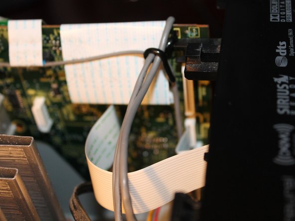

    9. Volume Control Potentiometer Cleaning, Unclip the faceplate: crwdns2935265:09crwdnd2935265:01crwdnd2935265:02crwdne2935265:0 Volume Control Potentiometer Cleaning, Unclip the faceplate: crwdns2935265:09crwdnd2935265:02crwdnd2935265:02crwdne2935265:0
      • Once the unit is reassembled, these zipties must be replaced. Failure to do this will result in protection mode errors.
      • Cut the zipties that hold the front panel wires on the fan. This provides better component access.

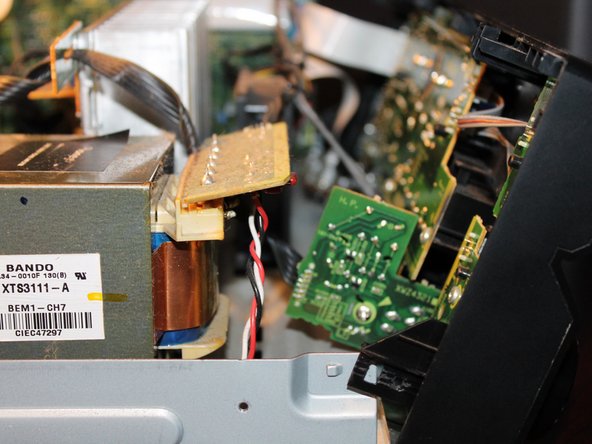

      • With the faceplate loose and all of the cables disconnected, unclip the faceplate one side at a time. Lay the faceplate flat on your workspace. Leave enough room to access the boards on the front panel.

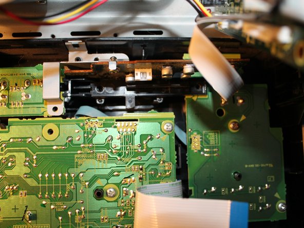

    10. Volume Control Potentiometer Cleaning, Remove the support bracket/iPod Direct board: crwdns2935265:010crwdnd2935265:01crwdnd2935265:03crwdne2935265:0 Volume Control Potentiometer Cleaning, Remove the support bracket/iPod Direct board: crwdns2935265:010crwdnd2935265:02crwdnd2935265:03crwdne2935265:0 Volume Control Potentiometer Cleaning, Remove the support bracket/iPod Direct board: crwdns2935265:010crwdnd2935265:03crwdnd2935265:03crwdne2935265:0
      • iPod Direct: Remove all 4 Phillips #1 screws. Remove the support bracket and PCB.
      • Non iPod Direct: Remove the Green and Red screws. No additional screws need to be removed.

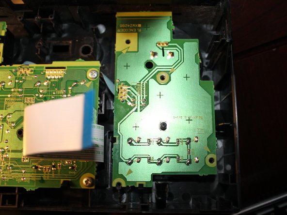

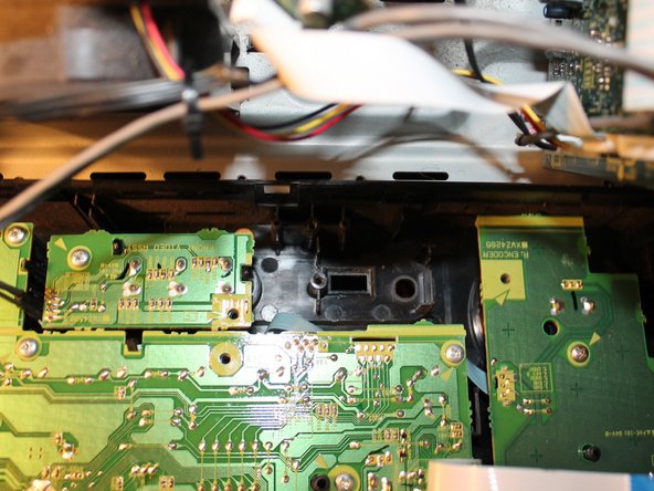

    11. Volume Control Potentiometer Cleaning, Remove the faulty control board: crwdns2935265:011crwdnd2935265:01crwdnd2935265:02crwdne2935265:0 Volume Control Potentiometer Cleaning, Remove the faulty control board: crwdns2935265:011crwdnd2935265:02crwdnd2935265:02crwdne2935265:0
      • WARNING: This screw is unique and has a different thrad. Sort it separately.
      • Remove the 3 Phillips #2 screws that hold the volume control board in the receiver's front faceplate.
    12. Volume Control Potentiometer Cleaning, Spray contact cleaner into the potentiometer: crwdns2935265:012crwdnd2935265:01crwdnd2935265:02crwdne2935265:0 Volume Control Potentiometer Cleaning, Spray contact cleaner into the potentiometer: crwdns2935265:012crwdnd2935265:02crwdnd2935265:02crwdne2935265:0
      • A little contact cleaner goes a long way. If you need to use more then 1-2 sprays, a replacement board may be required.
      • With the control board loose from the front panel, spray contact cleaner into the potentiometer. Clean up any excess contact cleaner once you are done.
