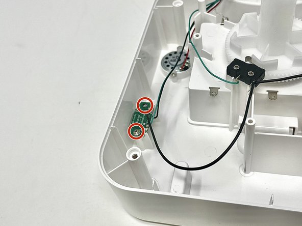

  6. Voluas VL001 USB Replacement, USB: crwdns2935265:06crwdnd2935265:01crwdnd2935265:02crwdne2935265:0 Voluas VL001 USB Replacement, USB: crwdns2935265:06crwdnd2935265:02crwdnd2935265:02crwdne2935265:0
    • Using a Phillips #2 screwdriver, carefully remove the two 11.2 mm screws on either side of the USB port.
  7. Voluas VL001 USB Replacement: crwdns2935265:07crwdnd2935265:01crwdnd2935265:02crwdne2935265:0 Voluas VL001 USB Replacement: crwdns2935265:07crwdnd2935265:02crwdnd2935265:02crwdne2935265:0
    • Using your wire strippers/pliers, cut the three wires that are connected to the USB port.

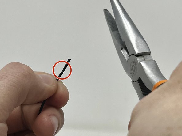

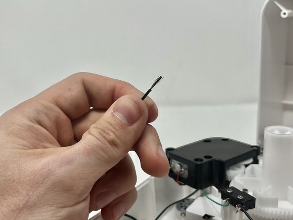

    • Using your wire strippers/pliers, gently crimp the plastic insulation on the wire. Do this several times around the wire to make sure that you can pull it off.
    • Because the wire is so thin, it can be easy to accidentally cut all the way through the wire on this step. Take care to only cut through the insulation.
    • You will want to see a score line in the insulation all around the wire like this.
    • Pull the end of the insulation off, exposing the wire.

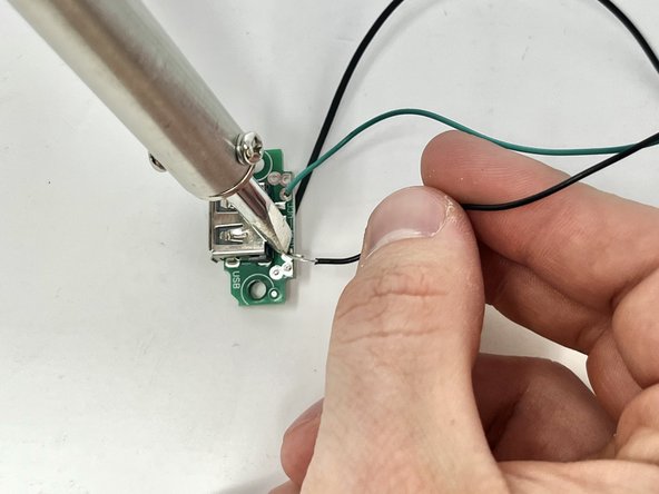

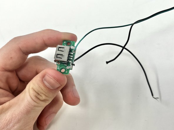

  9. Voluas VL001 USB Replacement: crwdns2935265:09crwdnd2935265:01crwdnd2935265:02crwdne2935265:0 Voluas VL001 USB Replacement: crwdns2935265:09crwdnd2935265:02crwdnd2935265:02crwdne2935265:0
    • Put the exposed wire on the solder patch, making sure it has good contact with the metal.
    • Solder the wire on to the solder patch.
    • Repeat steps 8 and 9 for the other two wires.
