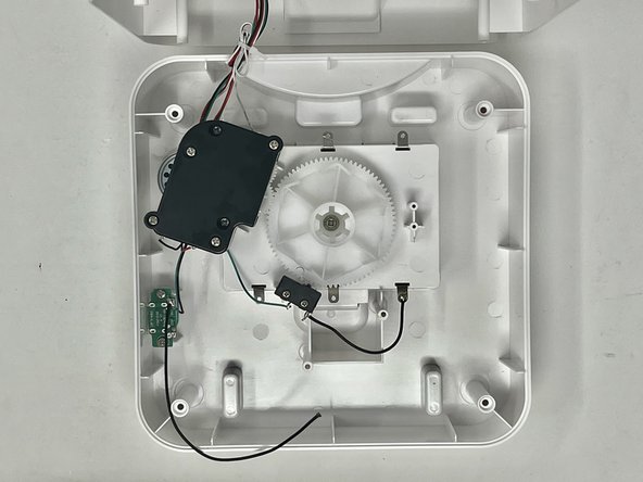

    • Turn the device over so it is oriented right-side up.
    • Lift the top part of the feeder off, exposing the mechanisms that run the feeder.

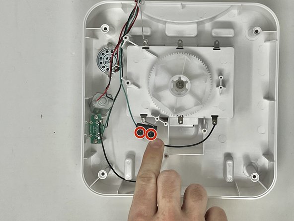

  6. Voluas VL001 Portion Switch Replacement, Portion Switch: crwdns2935265:06crwdnd2935265:01crwdnd2935265:03crwdne2935265:0 Voluas VL001 Portion Switch Replacement, Portion Switch: crwdns2935265:06crwdnd2935265:02crwdnd2935265:03crwdne2935265:0 Voluas VL001 Portion Switch Replacement, Portion Switch: crwdns2935265:06crwdnd2935265:03crwdnd2935265:03crwdne2935265:0
    • Remove the two 11.1 mm screws that secure the switch to the device using a Phillips #2 screwdriver.

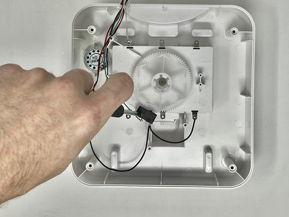

    • Using your wire strippers/pliers, cut the three wires that are connected to the switch.

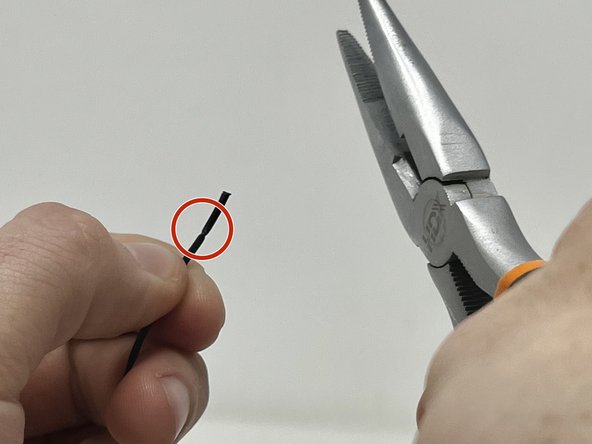

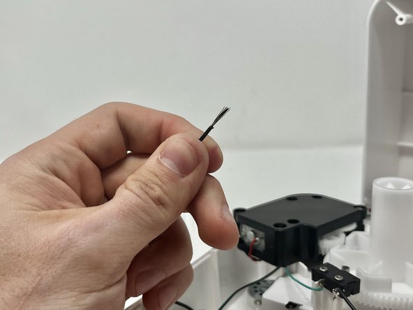

    • Using your wire strippers/pliers, gently crimp the plastic insulation on the wire. Do this several times around the wire to make sure that you can pull it off.
    • Because the wire is so thin, it can be easy to accidentally cut all the way through the wire on this step. Take care to only cut through the insulation.
    • You will want to see a score line in the insulation all around the wire like this.
    • Pull the end of the insulation off, exposing the wire.

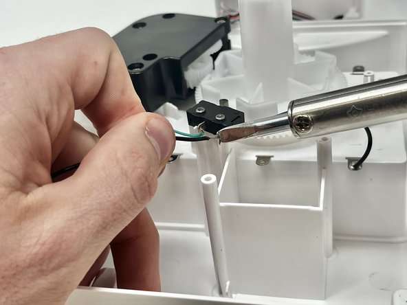

    • Put the exposed wire on the solder patch, making sure it has good contact with the metal.
    • Solder the wire on to the solder patch.
    • Repeat steps 8 and 9 for the other two wires.
