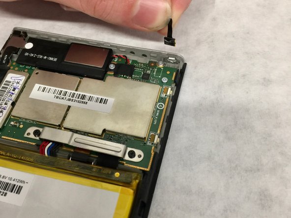

    • Using the tip of the nylon spudger, lift up the piece of black electrical tape in the upper right corner of the device.
    • Completely remove the tape using spudger or fingers.
  3. Vizio SmartCast Tablet Remote XR6M Power Button Replacement: crwdns2935265:03crwdnd2935265:01crwdnd2935265:02crwdne2935265:0 Vizio SmartCast Tablet Remote XR6M Power Button Replacement: crwdns2935265:03crwdnd2935265:02crwdnd2935265:02crwdne2935265:0
    • Slide the connector upwards with the nylon spudger to remove it.
    • Pull the flat cable up to remove the power button from the slot it is in.
