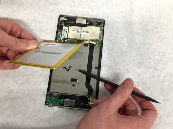

    • Hold the device in one hand with the screen facing down.
    • Insert the plastic opening tool under the back panel on the side of the device.
    • Slide the plastic opening tool down the side of the device, then repeat this process on all four sides of the device until the back panel pops off.
    • You may hear a popping noise when you pry off the back panel.
  2. Vizio SmartCast Tablet Remote XR6M Battery Replacement: crwdns2935265:02crwdnd2935265:01crwdnd2935265:03crwdne2935265:0 Vizio SmartCast Tablet Remote XR6M Battery Replacement: crwdns2935265:02crwdnd2935265:02crwdnd2935265:03crwdne2935265:0 Vizio SmartCast Tablet Remote XR6M Battery Replacement: crwdns2935265:02crwdnd2935265:03crwdnd2935265:03crwdne2935265:0
    • Use a driver with the T5 bit to remove the 3mm screws attaching the narrow metal plate to the main board.
  3. Vizio SmartCast Tablet Remote XR6M Battery Replacement: crwdns2935265:03crwdnd2935265:01crwdnd2935265:02crwdne2935265:0 Vizio SmartCast Tablet Remote XR6M Battery Replacement: crwdns2935265:03crwdnd2935265:02crwdnd2935265:02crwdne2935265:0
    • Slide the pointy end of the nylon spudger under the wires of the battery connector, and gently lift the wires away from the device, freeing the connector from the main board.
  4. Vizio SmartCast Tablet Remote XR6M Battery Replacement: crwdns2935265:04crwdnd2935265:01crwdnd2935265:02crwdne2935265:0 Vizio SmartCast Tablet Remote XR6M Battery Replacement: crwdns2935265:04crwdnd2935265:02crwdnd2935265:02crwdne2935265:0
    • To remove adhesive, insert the flat end of the plastic spudger under the battery. Slide it toward the top of the device until the battery pops free.
    • You may hear a popping noise when you pry off the battery.
