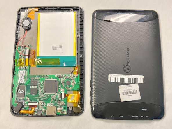

    • Lay your device face-down.
    • Use a Phillips #000 screwdriver to remove the two 4 mm screws next to the AUX port and microphone.
  2. Visual Land Prestige 7G Battery Replacement: crwdns2935265:02crwdnd2935265:01crwdnd2935265:01crwdne2935265:0

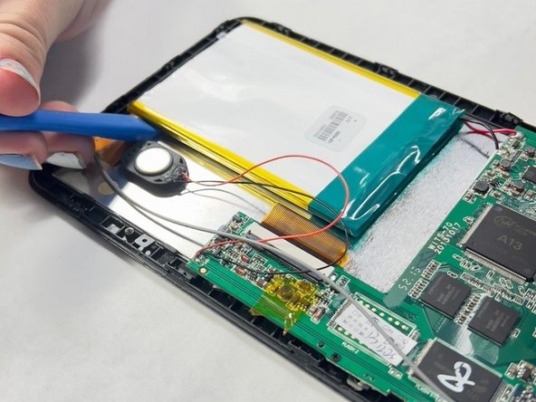

    • Pry open the back-plate using a Jimmy.
    • Do this by inserting the tool into the fine thin line between the back-plate and screen at each corner of the device.
  3. Visual Land Prestige 7G Battery Replacement: crwdns2935265:03crwdnd2935265:01crwdnd2935265:02crwdne2935265:0 Visual Land Prestige 7G Battery Replacement: crwdns2935265:03crwdnd2935265:02crwdnd2935265:02crwdne2935265:0
    • Lift off the backplate using your hand.
    • If the backplate is stuck, repeat the previous step to ensure all the edges are free.

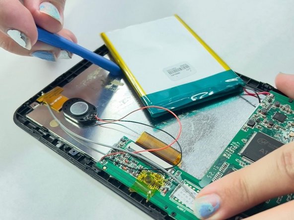

  4. Visual Land Prestige 7G Battery Replacement, Battery: crwdns2935265:04crwdnd2935265:01crwdnd2935265:03crwdne2935265:0 Visual Land Prestige 7G Battery Replacement, Battery: crwdns2935265:04crwdnd2935265:02crwdnd2935265:03crwdne2935265:0 Visual Land Prestige 7G Battery Replacement, Battery: crwdns2935265:04crwdnd2935265:03crwdnd2935265:03crwdne2935265:0
    • Use an opening tool to lift the battery from the device.
    • Be careful to not use a metal spudger or tool, as it can bend and harm the battery.

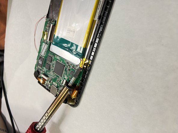

    • Take your soldering gun and carefully remove the red and black wire connecting the battery to the motherboard.
For optimal performance, calibrate your newly installed battery after completing this guide.
