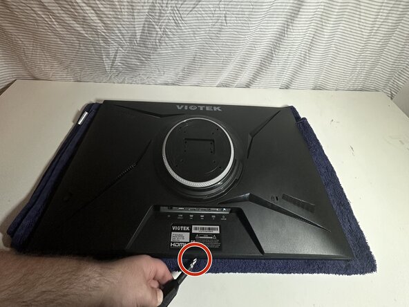

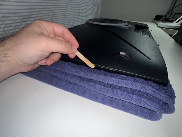

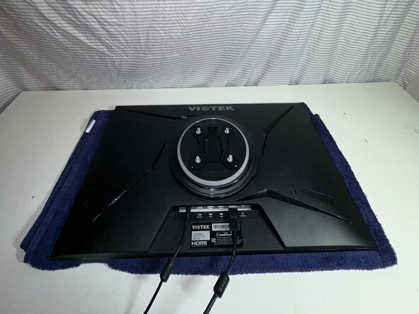

    • Clean your workspace and make sure you have enough room to lay the monitor down.
    • Place the monitor face down on a soft, static-free surface.

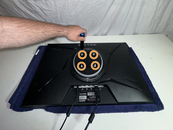

  2. Viotek Gaming Monitor W2711SE Back Panel Attachment Latch Repair: crwdns2935265:02crwdnd2935265:01crwdnd2935265:03crwdne2935265:0 Viotek Gaming Monitor W2711SE Back Panel Attachment Latch Repair: crwdns2935265:02crwdnd2935265:02crwdnd2935265:03crwdne2935265:0 Viotek Gaming Monitor W2711SE Back Panel Attachment Latch Repair: crwdns2935265:02crwdnd2935265:03crwdnd2935265:03crwdne2935265:0

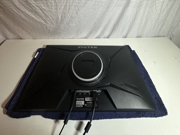

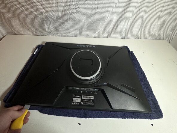

    • Before you begin, unplug all cables, starting with the display cable and then the power cable.
    • Use a Phillips screwdriver to remove four 24.5 mm screws from the center of the back panel.
  3. Viotek Gaming Monitor W2711SE Back Panel Attachment Latch Repair: crwdns2935265:03crwdnd2935265:01crwdnd2935265:03crwdne2935265:0 Viotek Gaming Monitor W2711SE Back Panel Attachment Latch Repair: crwdns2935265:03crwdnd2935265:02crwdnd2935265:03crwdne2935265:0 Viotek Gaming Monitor W2711SE Back Panel Attachment Latch Repair: crwdns2935265:03crwdnd2935265:03crwdnd2935265:03crwdne2935265:0

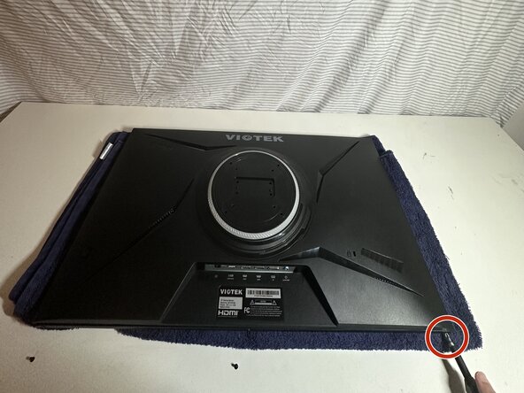

    • Use a Phillips #1 screwdriver to remove three 8.5 mm screws from the broken side of the panel.
    • Keep these screws organized so you don’t lose them.

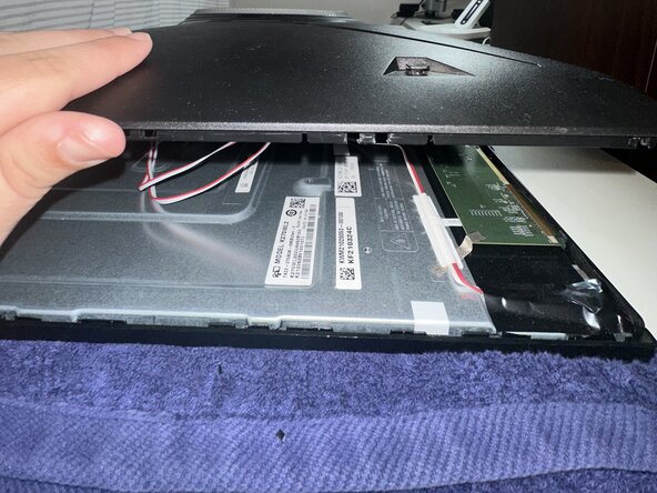

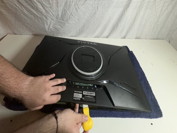

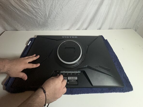

  4. Viotek Gaming Monitor W2711SE Back Panel Attachment Latch Repair: crwdns2935265:04crwdnd2935265:01crwdnd2935265:03crwdne2935265:0 Viotek Gaming Monitor W2711SE Back Panel Attachment Latch Repair: crwdns2935265:04crwdnd2935265:02crwdnd2935265:03crwdne2935265:0 Viotek Gaming Monitor W2711SE Back Panel Attachment Latch Repair: crwdns2935265:04crwdnd2935265:03crwdnd2935265:03crwdne2935265:0

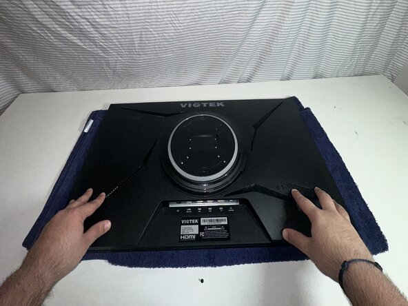

    • Use an opening tool to release the clips around the edge of the back panel, starting from the broken edge.
    • Do not force it. If you feel resistance, check that you've removed all of the screws securing the back panel. Avoid cracking other parts of the panel.

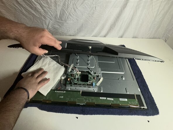

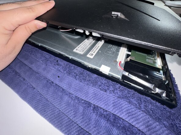

  5. Viotek Gaming Monitor W2711SE Back Panel Attachment Latch Repair: crwdns2935265:05crwdnd2935265:01crwdnd2935265:03crwdne2935265:0 Viotek Gaming Monitor W2711SE Back Panel Attachment Latch Repair: crwdns2935265:05crwdnd2935265:02crwdnd2935265:03crwdne2935265:0 Viotek Gaming Monitor W2711SE Back Panel Attachment Latch Repair: crwdns2935265:05crwdnd2935265:03crwdnd2935265:03crwdne2935265:0
    • Lift the panel slowly and check for any short internal cables that could be pulled.
    • Be careful not to rip any cables when lifting the panel.
    • Clean out any dust or debris inside the monitor.

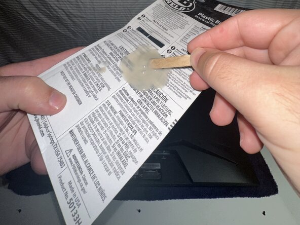

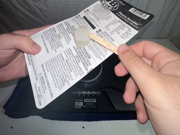

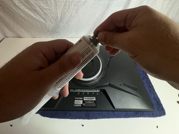

    • Follow the instructions on the package to prepare the epoxy.
    • Do not get epoxy on your hands. If you do, wash them immediately.
  7. Viotek Gaming Monitor W2711SE Back Panel Attachment Latch Repair: crwdns2935265:07crwdnd2935265:01crwdnd2935265:03crwdne2935265:0 Viotek Gaming Monitor W2711SE Back Panel Attachment Latch Repair: crwdns2935265:07crwdnd2935265:02crwdnd2935265:03crwdne2935265:0 Viotek Gaming Monitor W2711SE Back Panel Attachment Latch Repair: crwdns2935265:07crwdnd2935265:03crwdnd2935265:03crwdne2935265:0
    • Follow the instructions for how to prepare the specific epoxy are you using.
    • Dispense a small amount onto a flat, disposable surface like the back of the packaging.
    • Mix with the provided stick or a disposable one.
    • Always wear gloves or avoid skin contact.

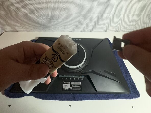

  8. Viotek Gaming Monitor W2711SE Back Panel Attachment Latch Repair: crwdns2935265:08crwdnd2935265:01crwdnd2935265:03crwdne2935265:0 Viotek Gaming Monitor W2711SE Back Panel Attachment Latch Repair: crwdns2935265:08crwdnd2935265:02crwdnd2935265:03crwdne2935265:0 Viotek Gaming Monitor W2711SE Back Panel Attachment Latch Repair: crwdns2935265:08crwdnd2935265:03crwdnd2935265:03crwdne2935265:0

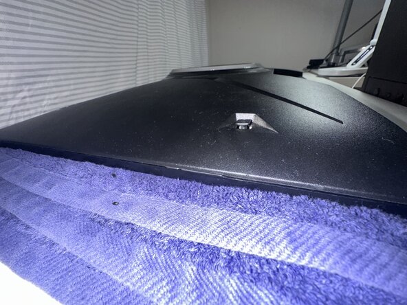

    • Carefully apply epoxy to the broken clip.
    • In this example, the clip was completely broken at the attachment point, so epoxy was used to build a new support on what remained.
    • If you used the epoxy to rebuild the latch, make sure to wait at least 15 minutes for it to harden before closing the monitor.
    • Avoid excess epoxy buildup and direct contact with your hands.

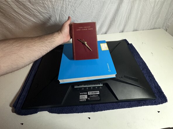

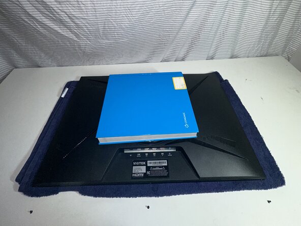

    • Once aligned, place a moderately heavy object on top of the monitor to keep pressure on the panel.
    • Use something flat and heavy enough to hold the panel down evenly.
  11. Viotek Gaming Monitor W2711SE Back Panel Attachment Latch Repair: crwdns2935265:011crwdnd2935265:01crwdnd2935265:03crwdne2935265:0 Viotek Gaming Monitor W2711SE Back Panel Attachment Latch Repair: crwdns2935265:011crwdnd2935265:02crwdnd2935265:03crwdne2935265:0 Viotek Gaming Monitor W2711SE Back Panel Attachment Latch Repair: crwdns2935265:011crwdnd2935265:03crwdnd2935265:03crwdne2935265:0
    • Set a timer for 15 minutes to let the epoxy cure. If you plan to sand it down, wait a full 30 minutes before doing so.
    • Always make sure to use the direction on the packaging of the epoxy.

    • Plug the cords back into the bottom of the monitor.
To reassemble your device, follow these instructions in reverse order. Take your e-waste to an R2 or e-Stewards certified recycler.
