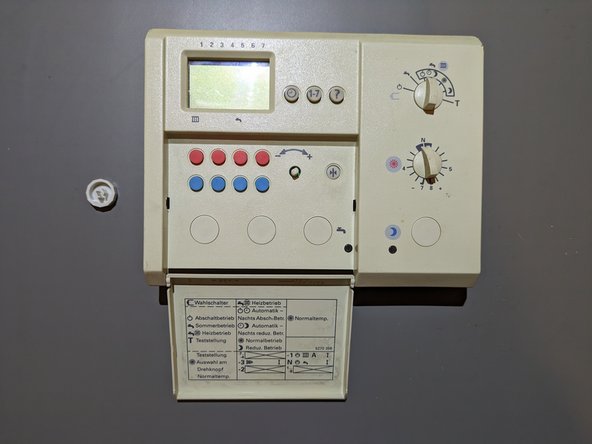

  6. Viessmann 7450156 Backup Battery Replacement, Remove the encoder knob: crwdns2935265:06crwdnd2935265:01crwdnd2935265:03crwdne2935265:0 Viessmann 7450156 Backup Battery Replacement, Remove the encoder knob: crwdns2935265:06crwdnd2935265:02crwdnd2935265:03crwdne2935265:0 Viessmann 7450156 Backup Battery Replacement, Remove the encoder knob: crwdns2935265:06crwdnd2935265:03crwdnd2935265:03crwdne2935265:0
    • Place the module on its back.
    • Open the flap that covers the buttons for setting the timer.
    • Remove the encoder knob by pulling it off.

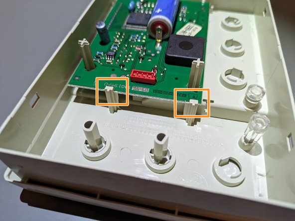

  7. Viessmann 7450156 Backup Battery Replacement, Remove the PCB: crwdns2935265:07crwdnd2935265:01crwdnd2935265:02crwdne2935265:0 Viessmann 7450156 Backup Battery Replacement, Remove the PCB: crwdns2935265:07crwdnd2935265:02crwdnd2935265:02crwdne2935265:0
    • Release the first two clips holding the PCB inside the housing.
    • Release the last two clips holding the PCB inside the housing.
    • Remove the PCB from the housing.
    • The last two clips might be a bit hard to release, though take care to not use too much force and break them.

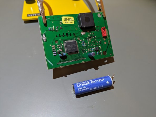

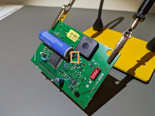

  8. Viessmann 7450156 Backup Battery Replacement, Desolder the battery: crwdns2935265:08crwdnd2935265:01crwdnd2935265:03crwdne2935265:0 Viessmann 7450156 Backup Battery Replacement, Desolder the battery: crwdns2935265:08crwdnd2935265:02crwdnd2935265:03crwdne2935265:0 Viessmann 7450156 Backup Battery Replacement, Desolder the battery: crwdns2935265:08crwdnd2935265:03crwdnd2935265:03crwdne2935265:0
    • Desolder the negative connection.
    • Desolder the positive connection.
    • See this guide on how to solder and desolder connections.
