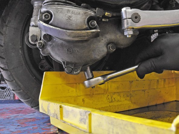

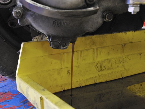

  4. Vespa Large Frame Oil Change, Draining the Oil: crwdns2935265:04crwdnd2935265:01crwdnd2935265:03crwdne2935265:0 Vespa Large Frame Oil Change, Draining the Oil: crwdns2935265:04crwdnd2935265:02crwdnd2935265:03crwdne2935265:0 Vespa Large Frame Oil Change, Draining the Oil: crwdns2935265:04crwdnd2935265:03crwdnd2935265:03crwdne2935265:0
    • Place an oil drain pan below the engine to catch the used oil.
    • Using an 10mm socket, unscrew the oil drain plug
    • Remove the oil drain plug, letting the oil drain out of the engine.
    • Wait for almost all of the oil to drain out of the engine, about five minutes.

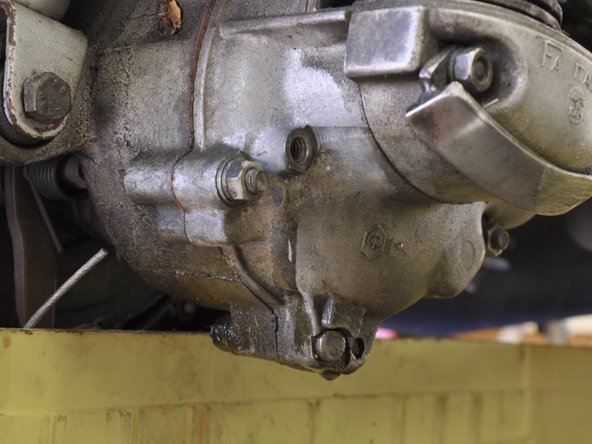

  5. Vespa Large Frame Oil Change, Adding New Oil: crwdns2935265:05crwdnd2935265:01crwdnd2935265:01crwdne2935265:0
    • Using your fingers, re-install and hand tighten the oil drain plug.
    • Using a 10mm socket, tighten the oil drain plug.
    • It is important to not over-tighten the oil drain plug, as the steel drain plug will easily strip the aluminum threads in the engine case.

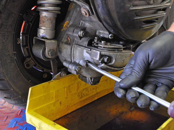

  6. Vespa Large Frame Oil Change: crwdns2935265:06crwdnd2935265:01crwdnd2935265:02crwdne2935265:0 Vespa Large Frame Oil Change: crwdns2935265:06crwdnd2935265:02crwdnd2935265:02crwdne2935265:0
    • Use a large flathead screwdriver to remove the oil fill plug.

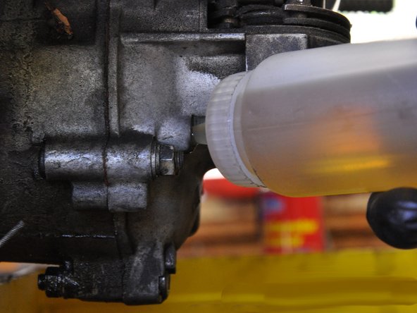

  7. Vespa Large Frame Oil Change: crwdns2935265:07crwdnd2935265:01crwdnd2935265:03crwdne2935265:0 Vespa Large Frame Oil Change: crwdns2935265:07crwdnd2935265:02crwdnd2935265:03crwdne2935265:0 Vespa Large Frame Oil Change: crwdns2935265:07crwdnd2935265:03crwdnd2935265:03crwdne2935265:0
    • Refilling the oil in the large-frame Vespa requires a narrow nozzle that will allow pouring oil horizontally. A condiment bottle works very well.
    • Put the nozzle of the oil bottle into the oil fill hole and pour or squirt oil into the engine until it is filled level with the fill hole.
    • It is important that the bike remains level while filling, if it is tilted one way or the other, you will over or under fill the engine. Oil will drip down the side of the engine. This is fine, just wipe it up when you are done.
  8. Vespa Large Frame Oil Change: crwdns2935265:08crwdnd2935265:01crwdnd2935265:01crwdne2935265:0
    • Using your hands, insert and hand-tighten the oil fill plug.
    • Using a large flathead screwdriver, tighten the oil fill plug.
    • There is no necessary torque specification for the oil fill plug. However, make sure that it is tight enough that it doesn't rattle out. It also should not be so tight that the threads strip.
