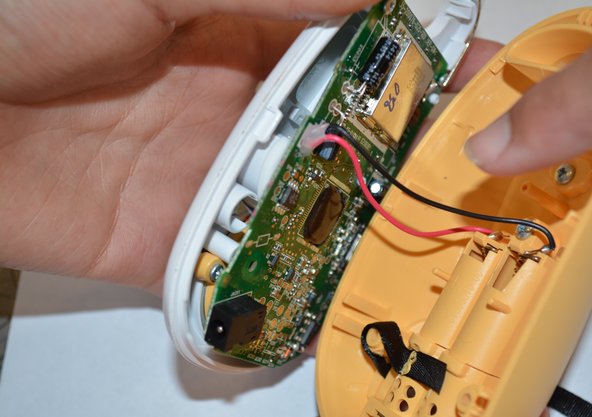

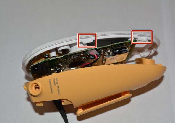

  4. VTech Safe and Sound DM111-2 Speaker Replacement: crwdns2935265:04crwdnd2935265:01crwdnd2935265:03crwdne2935265:0 VTech Safe and Sound DM111-2 Speaker Replacement: crwdns2935265:04crwdnd2935265:02crwdnd2935265:03crwdne2935265:0 VTech Safe and Sound DM111-2 Speaker Replacement: crwdns2935265:04crwdnd2935265:03crwdnd2935265:03crwdne2935265:0
    • Use a plastic opening tool to gently disconnect the clips holding the case together.
    • Be careful when taking the case apart there are wires attached to the back case and the motherboard which should not be disconnected.

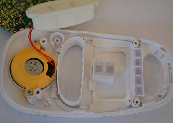

  5. VTech Safe and Sound DM111-2 Speaker Replacement: crwdns2935265:05crwdnd2935265:01crwdnd2935265:02crwdne2935265:0 VTech Safe and Sound DM111-2 Speaker Replacement: crwdns2935265:05crwdnd2935265:02crwdnd2935265:02crwdne2935265:0
    • Carefully unscrew the two 6.8 mm Philips head screws near the top of the device using the Philips#0 screw driver.
    • Be careful removing the motherboard because there will be a set of wires connecting the speaker and motherboard.
  6. VTech Safe and Sound DM111-2 Speaker Replacement: crwdns2935265:06crwdnd2935265:01crwdnd2935265:01crwdne2935265:0
    • Use a Philips#0 screwdriver and unscrew the two 6.8mm Philips screws holding the speaker in place.
  7. VTech Safe and Sound DM111-2 Speaker Replacement: crwdns2935265:07crwdnd2935265:01crwdnd2935265:01crwdne2935265:0
    • Remove the solder from the bottom left corner of the motherboard to completely detach the speaker from the device.
