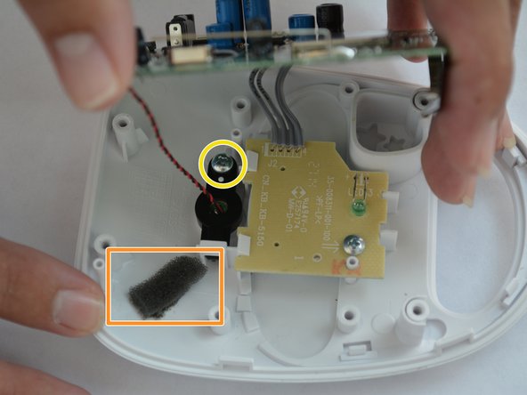

    • Remove the strip of adhesive tape located under the motherboard.
    • Gently lift the motherboard to expose the inner components.
    • Use a spudger to scrape away the adhesive and foam connecting the microphone.
    • Unscrew the 4mm phillips head screw holding the microphone in place.

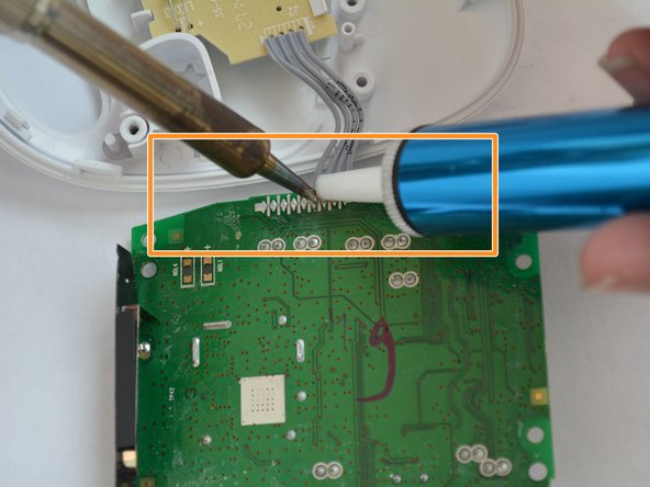

    • Before de-soldering, check to see no scorching or broken connections appear on the wires, power supply jack or antenna.
    • De-solder the connections from the motherboard using a soldering iron and a solder sucker.

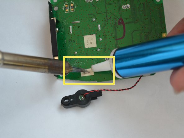

    • De-solder the connections to the microphone, located on the bottom left of the mother board.
    • De-solder the 4 wires connecting the LED board to the motherboard.
    • De-solder the antenna's solder joint, located above the microphone wire connection.
