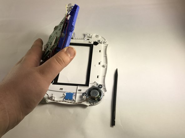

  6. VTech InnoTab 2s Screen Replacement, Motherboard: crwdns2935265:06crwdnd2935265:01crwdnd2935265:01crwdne2935265:0
    • First begin by removing the three cross-head screws using a J0 bit.
  7. VTech InnoTab 2s Screen Replacement: crwdns2935265:07crwdnd2935265:01crwdnd2935265:01crwdne2935265:0
    • First remove the ribbon cables. There are two highlighted by the red squares
    • Do not apply too much pressure and make sure that the black plastic tabs are fully open before you pull the cable out.
  8. VTech InnoTab 2s Screen Replacement: crwdns2935265:08crwdnd2935265:01crwdnd2935265:01crwdne2935265:0
    • Remove the camera from the assembly and put is a safe place so that it will not get damaged.
  9. VTech InnoTab 2s Screen Replacement: crwdns2935265:09crwdnd2935265:01crwdnd2935265:01crwdne2935265:0
    • Remove the board from the main assembly.
    • Be careful not to pull too hard so that the cables aren't broken.
  10. VTech InnoTab 2s Screen Replacement: crwdns2935265:010crwdnd2935265:01crwdnd2935265:01crwdne2935265:0
    • De-solder the points shown to fully remove the cables and free the board.
    • A soldering guide offered by IFIXIT can be found here Soldering Skills.
  11. VTech InnoTab 2s Screen Replacement, Screen: crwdns2935265:011crwdnd2935265:01crwdnd2935265:02crwdne2935265:0 VTech InnoTab 2s Screen Replacement, Screen: crwdns2935265:011crwdnd2935265:02crwdnd2935265:02crwdne2935265:0
    • After removing the back plate and screws, all screws have been removed to separate the circuit board and wires from the front panel.
    • Remove the front panel from the device to expose the screen.
