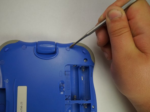

  3. VTech InnoTab 2S Motherboard Removal: crwdns2935265:03crwdnd2935265:01crwdnd2935265:03crwdne2935265:0 VTech InnoTab 2S Motherboard Removal: crwdns2935265:03crwdnd2935265:02crwdnd2935265:03crwdne2935265:0 VTech InnoTab 2S Motherboard Removal: crwdns2935265:03crwdnd2935265:03crwdnd2935265:03crwdne2935265:0
    • Remove all of the plastic tabs on the device. These are covering screws that will need to be removed.
    • These covers are made of hard plastic so they may be difficult to remove.
    • There is a special tab in the cartridge cover that is made of rubber, make sure to not break this tab.
