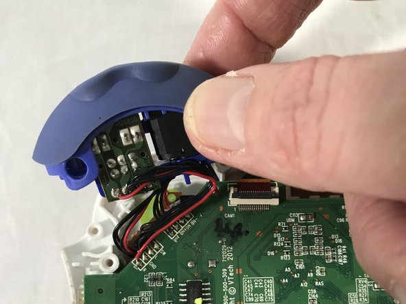

    1. VTech InnoTab 2 Headphone Jack Replacement, Headphone Jack: crwdns2935265:06crwdnd2935265:01crwdnd2935265:03crwdne2935265:0 VTech InnoTab 2 Headphone Jack Replacement, Headphone Jack: crwdns2935265:06crwdnd2935265:02crwdnd2935265:03crwdne2935265:0 VTech InnoTab 2 Headphone Jack Replacement, Headphone Jack: crwdns2935265:06crwdnd2935265:03crwdnd2935265:03crwdne2935265:0
      • Remove the two 7 mm screws from the left bumper of the device using a JO screwdriver.
      • Be careful not to pull to hard when removing the bumper to avoid damage to the circuit.

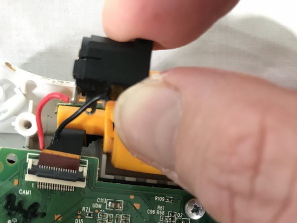

    2. VTech InnoTab 2 Headphone Jack Replacement: crwdns2935265:07crwdnd2935265:01crwdnd2935265:03crwdne2935265:0 VTech InnoTab 2 Headphone Jack Replacement: crwdns2935265:07crwdnd2935265:02crwdnd2935265:03crwdne2935265:0 VTech InnoTab 2 Headphone Jack Replacement: crwdns2935265:07crwdnd2935265:03crwdnd2935265:03crwdne2935265:0
      • Use your fingers to gently remove the headphone jack.
      • De-solder the points shown to fully remove the headphone jack from the motherboard.
      • A soldering guide offered by IFIXIT can be found here Soldering Skills
