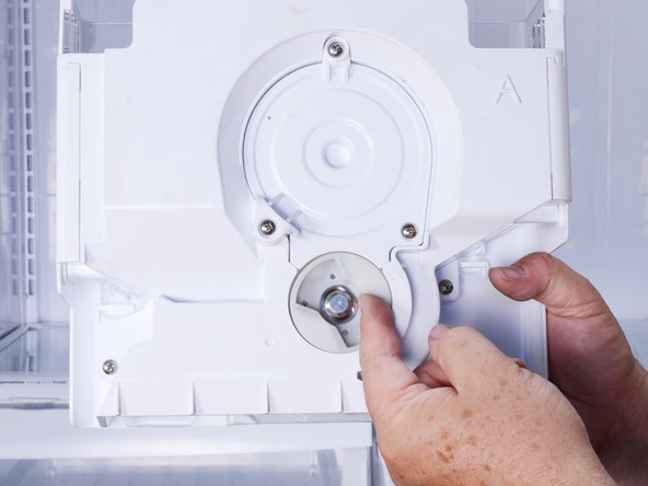

  4. Upper Ice Maker Replacement, Remove the ice bucket: crwdns2935265:04crwdnd2935265:01crwdnd2935265:03crwdne2935265:0 Upper Ice Maker Replacement, Remove the ice bucket: crwdns2935265:04crwdnd2935265:02crwdnd2935265:03crwdne2935265:0 Upper Ice Maker Replacement, Remove the ice bucket: crwdns2935265:04crwdnd2935265:03crwdnd2935265:03crwdne2935265:0
    • Using two hands, lift up the ice bucket slightly to release it.
    • Pull the bottom edge of the ice bucket toward you slightly and remove it.
  5. Upper Ice Maker Replacement, Reassembly notes: crwdns2935265:05crwdnd2935265:01crwdnd2935265:03crwdne2935265:0 Upper Ice Maker Replacement, Reassembly notes: crwdns2935265:05crwdnd2935265:02crwdnd2935265:03crwdne2935265:0 Upper Ice Maker Replacement, Reassembly notes: crwdns2935265:05crwdnd2935265:03crwdnd2935265:03crwdne2935265:0
    • The drive hub notches and drive blade wings must line up before installing the ice bucket.
    • Rotate the ice bucket hub, located on the rear of the ice bucket, with your hand so that the notches will align with the auger motor drive blades.

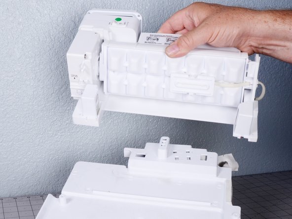

  7. Upper Ice Maker Replacement, Reposition the ice maker assembly: crwdns2935265:07crwdnd2935265:01crwdnd2935265:03crwdne2935265:0 Upper Ice Maker Replacement, Reposition the ice maker assembly: crwdns2935265:07crwdnd2935265:02crwdnd2935265:03crwdne2935265:0 Upper Ice Maker Replacement, Reposition the ice maker assembly: crwdns2935265:07crwdnd2935265:03crwdnd2935265:03crwdne2935265:0
    • Use a spudger to lift the bottom edge of the ice maker assembly. This action will release the assembly from the refrigerator door.
    • Pull the bottom edge of the ice maker assembly toward you to free it from the door.
  8. Upper Ice Maker Replacement: crwdns2935265:08crwdnd2935265:01crwdnd2935265:03crwdne2935265:0 Upper Ice Maker Replacement: crwdns2935265:08crwdnd2935265:02crwdnd2935265:03crwdne2935265:0 Upper Ice Maker Replacement: crwdns2935265:08crwdnd2935265:03crwdnd2935265:03crwdne2935265:0
    • Lower the ice maker assembly until you can access the connector located at the top of the assembly.
    • Squeeze the connector at the top of the ice maker assembly to release it.
    • Pull the connector straight down to disconnect it.
  9. Upper Ice Maker Replacement, Remove the ice maker assembly: crwdns2935265:09crwdnd2935265:01crwdnd2935265:01crwdne2935265:0
    • Remove the ice maker assembly.

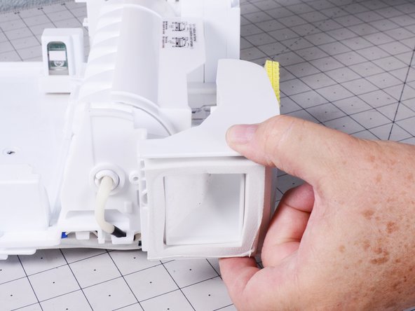

  10. Upper Ice Maker Replacement, Remove the air duct from the ice maker: crwdns2935265:010crwdnd2935265:01crwdnd2935265:01crwdne2935265:0
    • Use a Phillips screwdriver to remove the 14.4 mm‑long air duct screw from the side of the ice maker assembly.
    • The air duct gasket partially covers this screw.
  11. Upper Ice Maker Replacement: crwdns2935265:011crwdnd2935265:01crwdnd2935265:02crwdne2935265:0 Upper Ice Maker Replacement: crwdns2935265:011crwdnd2935265:02crwdnd2935265:02crwdne2935265:0
    • Remove the air duct.

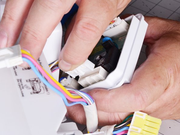

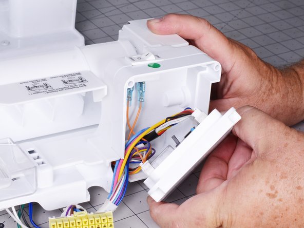

  12. Upper Ice Maker Replacement, Remove the circuit board cover: crwdns2935265:012crwdnd2935265:01crwdnd2935265:01crwdne2935265:0
    • Use a Phillips screwdriver to remove the two 32.5 mm‑long screws securing the circuit board cover.
  13. Upper Ice Maker Replacement: crwdns2935265:013crwdnd2935265:01crwdnd2935265:02crwdne2935265:0 Upper Ice Maker Replacement: crwdns2935265:013crwdnd2935265:02crwdnd2935265:02crwdne2935265:0
    • Open the circuit board cover.
    • The circuit board cover has wires that must be disconnected before removing the ice maker.

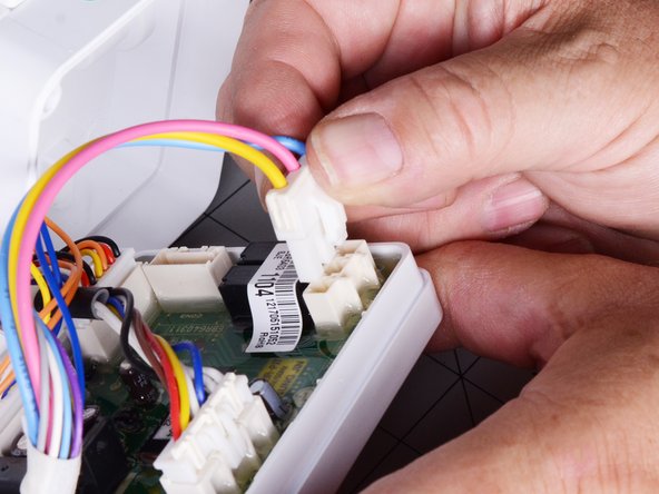

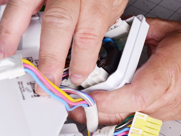

  14. Upper Ice Maker Replacement, Disconnect the ice maker wiring harness: crwdns2935265:014crwdnd2935265:01crwdnd2935265:02crwdne2935265:0 Upper Ice Maker Replacement, Disconnect the ice maker wiring harness: crwdns2935265:014crwdnd2935265:02crwdnd2935265:02crwdne2935265:0
    • Squeeze the three-wire connector to release it from the circuit board.
    • Pull the three-wire connector straight out to disconnect it.
  15. Upper Ice Maker Replacement: crwdns2935265:015crwdnd2935265:01crwdnd2935265:03crwdne2935265:0 Upper Ice Maker Replacement: crwdns2935265:015crwdnd2935265:02crwdnd2935265:03crwdne2935265:0 Upper Ice Maker Replacement: crwdns2935265:015crwdnd2935265:03crwdnd2935265:03crwdne2935265:0
    • Squeeze the multi-wire connector with the two orange wires running to the on/off switch.
    • Pull the connector straight out to disconnect it.

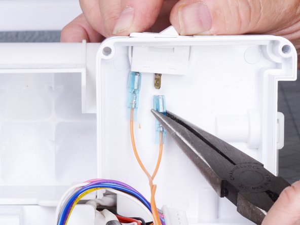

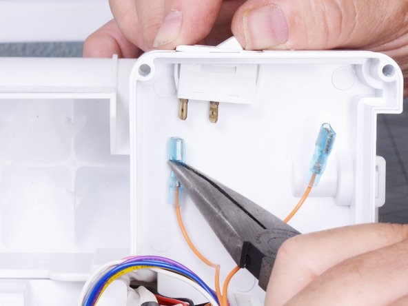

  16. Upper Ice Maker Replacement: crwdns2935265:016crwdnd2935265:01crwdnd2935265:03crwdne2935265:0 Upper Ice Maker Replacement: crwdns2935265:016crwdnd2935265:02crwdnd2935265:03crwdne2935265:0 Upper Ice Maker Replacement: crwdns2935265:016crwdnd2935265:03crwdnd2935265:03crwdne2935265:0
    • Use long nose pliers to pull the two spade connectors straight off the on-off switch terminals.
