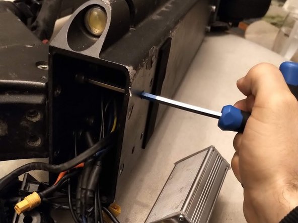

    • Use your 5 mm Allen wrench to remove the 2 bolts at the bottom of the scooter's deck, at the very front.
    • These 2 bolts hold the front panel in place.

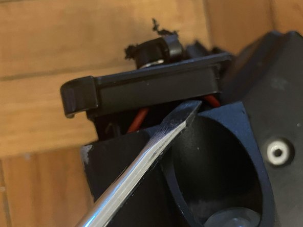

    • Use your flathead screwdriver/prying tool to pry the front panel off. Move the prying tool around the panel, and try to apply pressure evenly around the panel (dont pull the entire right half out and leave the left half inside the frame).
    • We are using the prying tool to "break the seal" of the front panel, as it is wedged inside the scooter very firmly.
    • The plastic is very hard but quite brittle, and is prone to breaking if you apply too much force with the prying tool.
  4. Unicool Titan T8 Battery Replacement: crwdns2935265:04crwdnd2935265:01crwdnd2935265:02crwdne2935265:0 Unicool Titan T8 Battery Replacement: crwdns2935265:04crwdnd2935265:02crwdnd2935265:02crwdne2935265:0
    • When the front panel is loose enough that you can wiggle it with your fingers, hold on to the front panel around the edges of it, and pull it straight out.

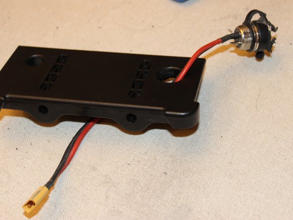

  5. Unicool Titan T8 Battery Replacement: crwdns2935265:05crwdnd2935265:01crwdnd2935265:03crwdne2935265:0 Unicool Titan T8 Battery Replacement: crwdns2935265:05crwdnd2935265:02crwdnd2935265:03crwdne2935265:0 Unicool Titan T8 Battery Replacement: crwdns2935265:05crwdnd2935265:03crwdnd2935265:03crwdne2935265:0

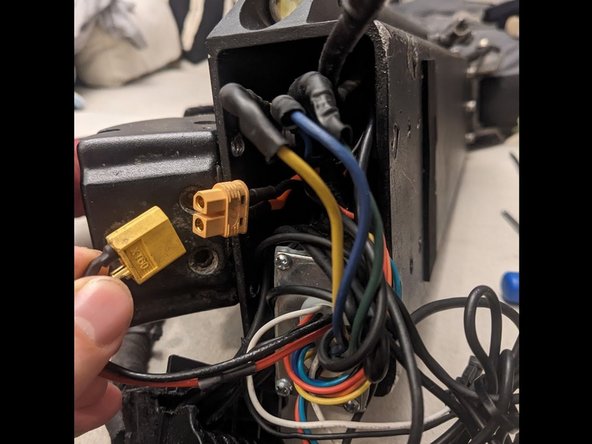

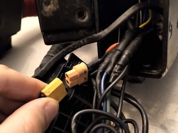

    • Disconnect the charging plug from the battery, by disconnecting the yellow connector (attached to a red wire and a black wire).
    • This will make it easier to work inside of the deck of the scooter.
    • The 3-pin aviation connector (charging port) is very dangerous - don't put anything metal anywhere close to the prongs, as it will arc or explode.
    • Pull all of the wires out of the deck so that you can work on them.
    • Do not force anything - some of the wires are very thin.
    • Be very gentle while pulling on the wires, and stop pulling if you feel any resistance.

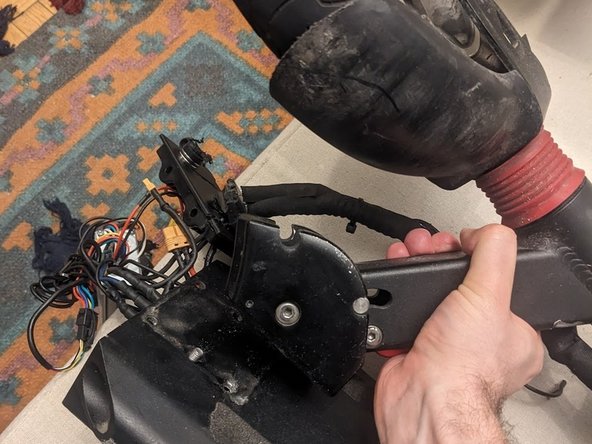

  6. Unicool Titan T8 Battery Replacement: crwdns2935265:07crwdnd2935265:01crwdnd2935265:03crwdne2935265:0 Unicool Titan T8 Battery Replacement: crwdns2935265:07crwdnd2935265:02crwdnd2935265:03crwdne2935265:0 Unicool Titan T8 Battery Replacement: crwdns2935265:07crwdnd2935265:03crwdnd2935265:03crwdne2935265:0

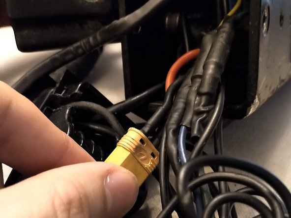

    • The wires and components should be fully removed from the deck of the scooter.
    • Hold the yellow XT1 connector and disconnect it.
    • The silver controller is now no longer attached to the battery.
  7. Unicool Titan T8 Battery Replacement: crwdns2935265:08crwdnd2935265:01crwdnd2935265:03crwdne2935265:0 Unicool Titan T8 Battery Replacement: crwdns2935265:08crwdnd2935265:02crwdnd2935265:03crwdne2935265:0 Unicool Titan T8 Battery Replacement: crwdns2935265:08crwdnd2935265:03crwdnd2935265:03crwdne2935265:0

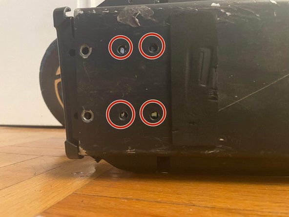

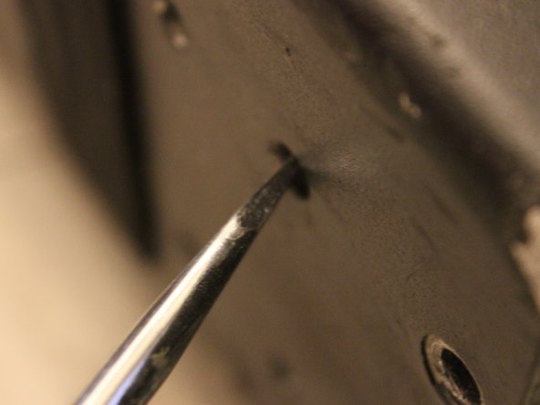

    • Flip the scooter over on its side or upside down again, to reveal the underside of the scooter. There are 4 rubber nubs covering 4 holes underneath the scooter's deck.
    • Using your prying tool, remove the 4 little rubber nubs.
  8. Unicool Titan T8 Battery Replacement: crwdns2935265:09crwdnd2935265:01crwdnd2935265:03crwdne2935265:0 Unicool Titan T8 Battery Replacement: crwdns2935265:09crwdnd2935265:02crwdnd2935265:03crwdne2935265:0 Unicool Titan T8 Battery Replacement: crwdns2935265:09crwdnd2935265:03crwdnd2935265:03crwdne2935265:0

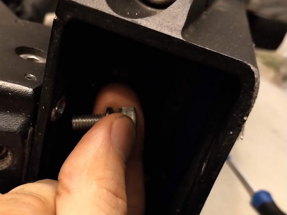

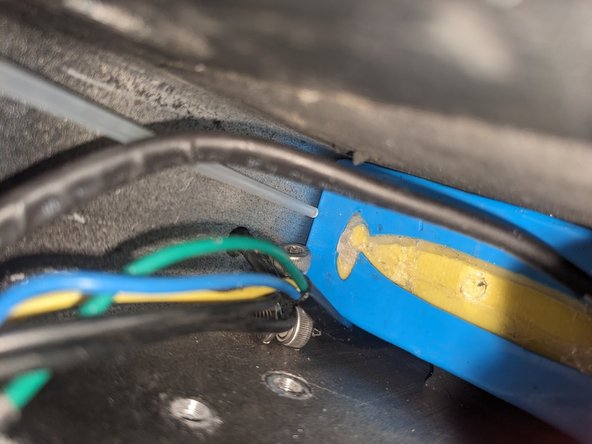

    • Flip the scooter upside down and insert the 5 mm Allen wrench into the 4 slots that were exposed by removing the rubber nubs. Make sure that no wires are in the way.
    • Make sure that the scooter's stem is secured - These 4 bolts keep the scooter's stem in place, so once removed the stem will not be attached.
    • The seal is quite tough, but once it's broken the bolt should come right out of the scooter.
  9. Unicool Titan T8 Battery Replacement: crwdns2935265:010crwdnd2935265:01crwdnd2935265:03crwdne2935265:0 Unicool Titan T8 Battery Replacement: crwdns2935265:010crwdnd2935265:02crwdnd2935265:03crwdne2935265:0 Unicool Titan T8 Battery Replacement: crwdns2935265:010crwdnd2935265:03crwdnd2935265:03crwdne2935265:0

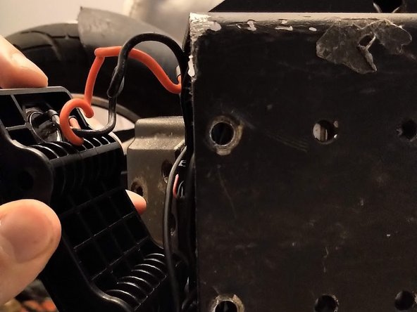

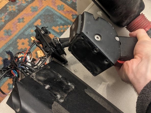

    • Flip the scooter on its side and detach the stem.
    • It should come off effortlessly and with no tools, as nothing is attaching the stem to the scooter.
    • Move the stem to the side, being wary that there are still some wires anchoring it to the base of the scooter.

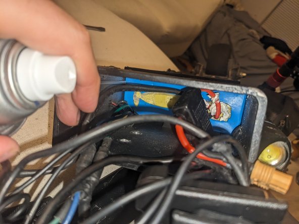

    • Apply an ample amount of WD-40 to all 4 sides of the battery. As we can not get a grip on the battery, you can either VERY GENTLY use the prying tool to pull it out (stop at ANY resistance) or you can pull on the red and black wire attached to the DC converter.
    • Do not pull if there is any resistance.
    • Your can of WD-40 should have a thin nozzle that can be inserted between the thin gap between the battery and the chassis.
