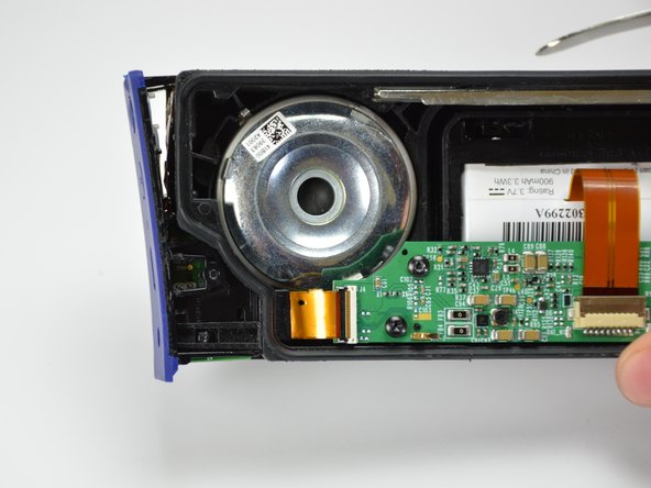

    5. USB/Auxiliary Port: crwdns2935265:05crwdnd2935265:01crwdnd2935265:03crwdne2935265:0 USB/Auxiliary Port: crwdns2935265:05crwdnd2935265:02crwdnd2935265:03crwdne2935265:0 USB/Auxiliary Port: crwdns2935265:05crwdnd2935265:03crwdnd2935265:03crwdne2935265:0
      • Push against the side without end cap to slide the internal components out of the case.
      • While holding the metal outset casing with one hand, press on the black inner plastic casing with your thumb.
      • It will be very difficult the first time. There is a rubber seal on the outside of the plastic inner case that creates a lot of friction with the metal outer case.

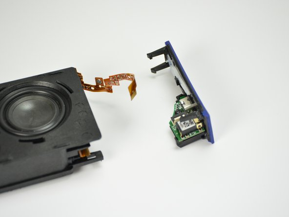

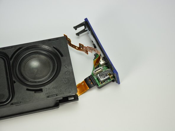

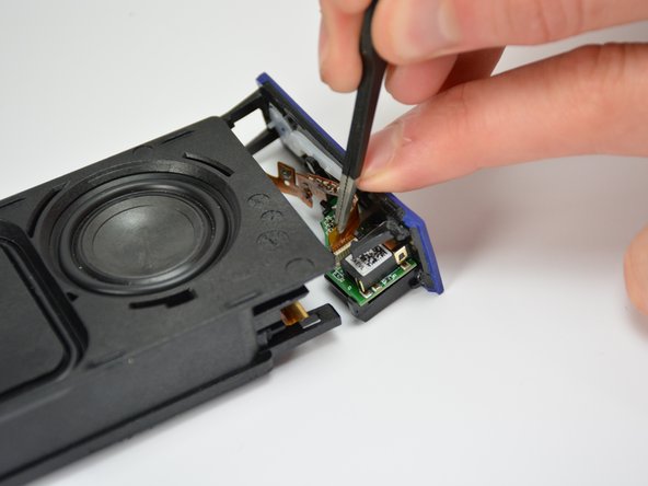

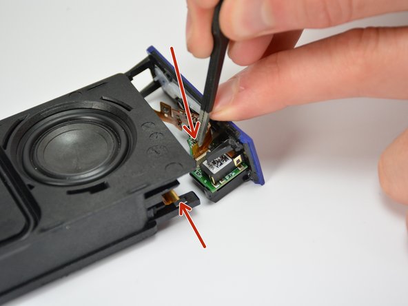

    3. USB/Auxiliary Port: crwdns2935265:08crwdnd2935265:01crwdnd2935265:03crwdne2935265:0 USB/Auxiliary Port: crwdns2935265:08crwdnd2935265:02crwdnd2935265:03crwdne2935265:0 USB/Auxiliary Port: crwdns2935265:08crwdnd2935265:03crwdnd2935265:03crwdne2935265:0
      • Carefully lift out the end panel.
      • Unplug both the connection ribbon and the ZIF ribbon using tweezers or your hands.
      • There is a bit of glue to hold the connection ribbon down.

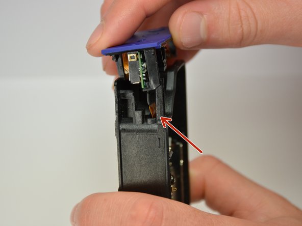

    7. USB/Auxiliary Port: crwdns2935265:012crwdnd2935265:01crwdnd2935265:01crwdne2935265:0
      • Very carefully pull the motherboard connection ribbon through the plastic casing, removing it from the plastic casing.
