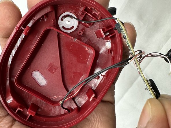

      • Cut the talkback cable below where it enters the speaker housing.
      • Remove the cut section of the talkback cable.

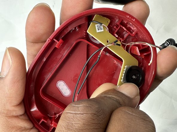

    4. Turtle Beach Recon 70P Talkback Cable Replacement: crwdns2935265:04crwdnd2935265:01crwdnd2935265:03crwdne2935265:0 Turtle Beach Recon 70P Talkback Cable Replacement: crwdns2935265:04crwdnd2935265:02crwdnd2935265:03crwdne2935265:0 Turtle Beach Recon 70P Talkback Cable Replacement: crwdns2935265:04crwdnd2935265:03crwdnd2935265:03crwdne2935265:0
      • You may need to move the speaker wire out of site so it will not block the motherboard.
      • Lift the motherboard up and out of the housing.
      • Take care not to strain the wires.

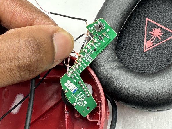

      • Desolder all of the talkback cable motherboard connections.

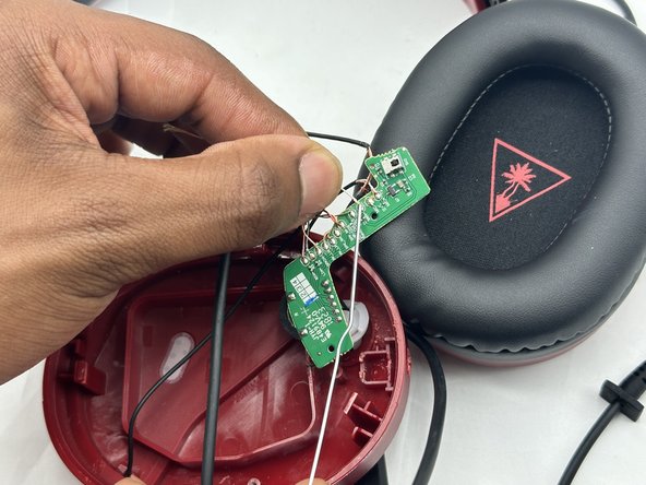

    6. Turtle Beach Recon 70P Talkback Cable Replacement: crwdns2935265:06crwdnd2935265:01crwdnd2935265:03crwdne2935265:0 Turtle Beach Recon 70P Talkback Cable Replacement: crwdns2935265:06crwdnd2935265:02crwdnd2935265:03crwdne2935265:0 Turtle Beach Recon 70P Talkback Cable Replacement: crwdns2935265:06crwdnd2935265:03crwdnd2935265:03crwdne2935265:0
      • Feed the replacement talkback cable through the housing, then solder every wire onto the motherboard's connection points in the order they were initially found.
      • The purpose of each wire is designated in small text on the motherboard.
