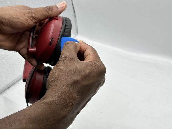

      • Gently pull the edge of the ear pads until the leather comes loose from the slot.
      • Be careful to not tear the fabric if you intend to reuse the ear pads.
    2. Turtle Beach Recon 70P Ear Pads Replacement: crwdns2935265:02crwdnd2935265:01crwdnd2935265:03crwdne2935265:0 Turtle Beach Recon 70P Ear Pads Replacement: crwdns2935265:02crwdnd2935265:02crwdnd2935265:03crwdne2935265:0 Turtle Beach Recon 70P Ear Pads Replacement: crwdns2935265:02crwdnd2935265:03crwdnd2935265:03crwdne2935265:0
      • Ensure the ear pad is orientated correctly.
      • To install new ear pads, insert part of the edge of the ear pad into the slot, then gently stretch it over the speaker housing.
    3. Turtle Beach Recon 70P Ear Pads Replacement: crwdns2935265:03crwdnd2935265:01crwdnd2935265:02crwdne2935265:0 Turtle Beach Recon 70P Ear Pads Replacement: crwdns2935265:03crwdnd2935265:02crwdnd2935265:02crwdne2935265:0
      • Using your finger nail or an opening pick, push the remaining leather into the slot.
Your ear pads should be replaced if all these steps were followed correctly.
