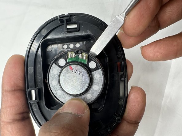

    • Before continuing, remove the ear pad(s) from the nonfunctional speaker(s) following the earpad replacement guide.
    • Use a spudger to pry up and remove the black plastic cover.
  2. Turtle Beach Recon 70P Speakers Replacement: crwdns2935265:02crwdnd2935265:01crwdnd2935265:02crwdne2935265:0 Turtle Beach Recon 70P Speakers Replacement: crwdns2935265:02crwdnd2935265:02crwdnd2935265:02crwdne2935265:0
    • Use flush cutters to cut the wires as close to the speaker connections as possible.

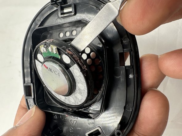

    • Use a spudger to pry the speaker out of its housing.
    • The speaker is attached to the housing with adhesive, so moderate force may be necessary to pry it out of place..

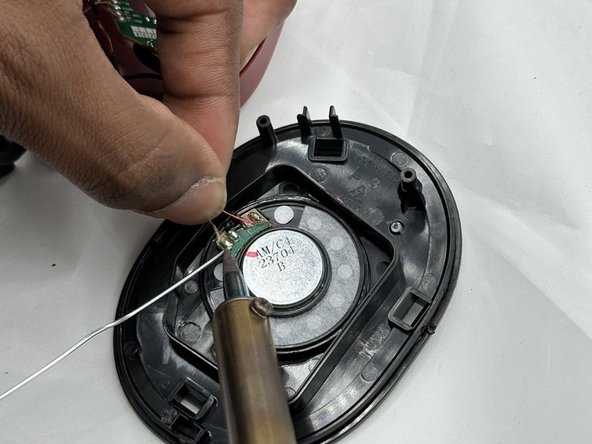

  4. Turtle Beach Recon 70P Speakers Replacement: crwdns2935265:04crwdnd2935265:01crwdnd2935265:02crwdne2935265:0 Turtle Beach Recon 70P Speakers Replacement: crwdns2935265:04crwdnd2935265:02crwdnd2935265:02crwdne2935265:0
    • Insert the new speaker into the plastic housing, sealing it in place with glue or tape.
    • Solder the wires in the order they were previously found.
