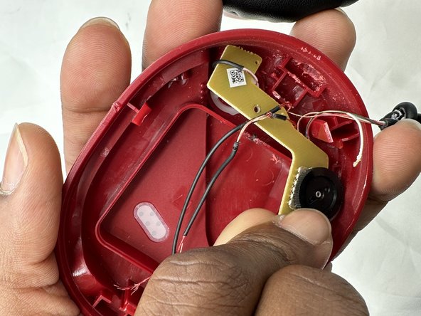

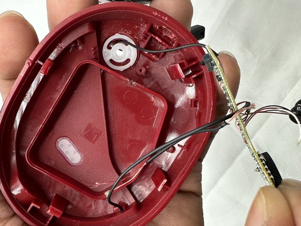

    • Use a Phillips screwdriver to remove the two 5 mm screws that secure the motherboard.
  3. Turtle Beach Recon 70P Motherboard Replacement: crwdns2935265:03crwdnd2935265:01crwdnd2935265:03crwdne2935265:0 Turtle Beach Recon 70P Motherboard Replacement: crwdns2935265:03crwdnd2935265:02crwdnd2935265:03crwdne2935265:0 Turtle Beach Recon 70P Motherboard Replacement: crwdns2935265:03crwdnd2935265:03crwdnd2935265:03crwdne2935265:0
    • You may need to move the speaker so it does not block the path of the motherboard.
    • Remove the motherboard from the headset by up and away from the volume wheel.
    • Take care not to strain the connections.

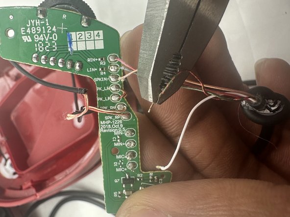

  4. Turtle Beach Recon 70P Motherboard Replacement: crwdns2935265:04crwdnd2935265:01crwdnd2935265:02crwdne2935265:0 Turtle Beach Recon 70P Motherboard Replacement: crwdns2935265:04crwdnd2935265:02crwdnd2935265:02crwdne2935265:0
    • Before replacing the motherboard, use flush cutters to cut each wire connected to the motherboard.
    • Cut the wires as close as possible to their connections.
    • Take note of how each component connects to the motherboard.

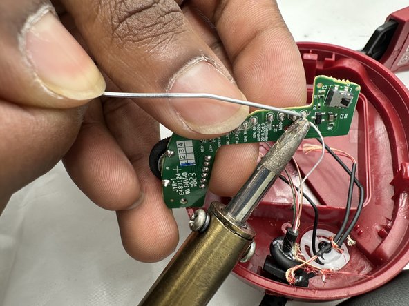

  5. Turtle Beach Recon 70P Motherboard Replacement: crwdns2935265:05crwdnd2935265:01crwdnd2935265:02crwdne2935265:0 Turtle Beach Recon 70P Motherboard Replacement: crwdns2935265:05crwdnd2935265:02crwdnd2935265:02crwdne2935265:0
    • Prepare your replacement motherboard before continuing.
    • Solder each wire of the new motherboard in the same spots they were originally found.
    • Soldering irons can cause burns, fires and device damage. Always solder in a well-ventilated area.
