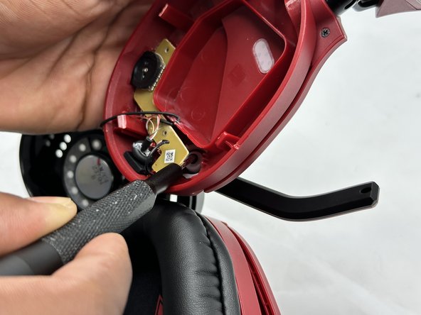

    1. Turtle Beach Recon 70P Microphone Replacement, Microphone: crwdns2935265:01crwdnd2935265:01crwdnd2935265:02crwdne2935265:0 Turtle Beach Recon 70P Microphone Replacement, Microphone: crwdns2935265:01crwdnd2935265:02crwdnd2935265:02crwdne2935265:0
      • Before continuing, remove the left ear pad with the earpad replacement guide.
      • Ensure that you are removing the side that houses the microphone.
      • Use a spudger to pry up the black plastic housing.
      • Remove the plastic cover.

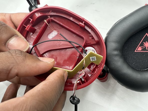

    3. Turtle Beach Recon 70P Microphone Replacement: crwdns2935265:03crwdnd2935265:01crwdnd2935265:03crwdne2935265:0 Turtle Beach Recon 70P Microphone Replacement: crwdns2935265:03crwdnd2935265:02crwdnd2935265:03crwdne2935265:0 Turtle Beach Recon 70P Microphone Replacement: crwdns2935265:03crwdnd2935265:03crwdnd2935265:03crwdne2935265:0
      • Use a Phillips screwdriver to remove the single 8 mm screw under the motherboard that secures the microphone.

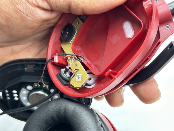

    4. Turtle Beach Recon 70P Microphone Replacement: crwdns2935265:04crwdnd2935265:01crwdnd2935265:03crwdne2935265:0 Turtle Beach Recon 70P Microphone Replacement: crwdns2935265:04crwdnd2935265:02crwdnd2935265:03crwdne2935265:0 Turtle Beach Recon 70P Microphone Replacement: crwdns2935265:04crwdnd2935265:03crwdnd2935265:03crwdne2935265:0
      • You may need to move the wire connecting to the speaker to easily remove the motherboard.
      • Remove the circuit board from the housing.
      • Take care not to strain the wires.

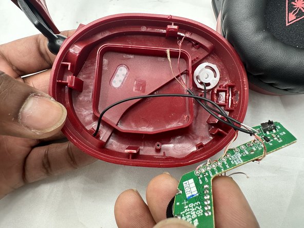

    5. Turtle Beach Recon 70P Microphone Replacement: crwdns2935265:05crwdnd2935265:01crwdnd2935265:01crwdne2935265:0
      • Desolder the microphone connections.
      • Soldering irons can cause burns and fires. Always solder and desolder in a well-ventilated workspace.
