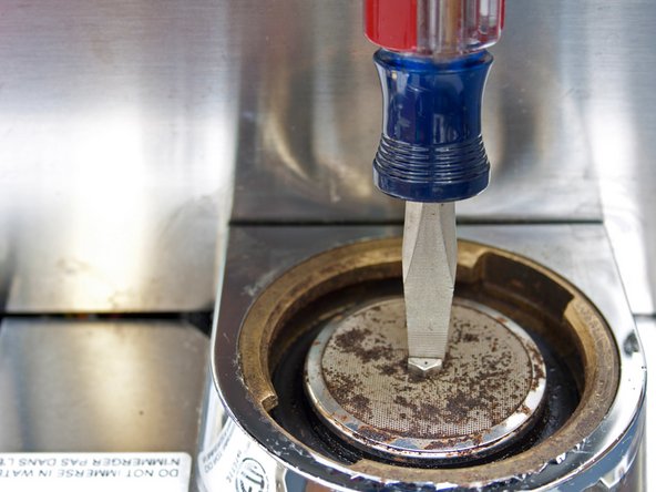

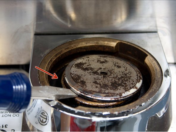

  4. Tune-up A Rancilio Silvia Espresso Machine, Removing Screen and Diffuser: crwdns2935265:04crwdnd2935265:01crwdnd2935265:03crwdne2935265:0 Tune-up A Rancilio Silvia Espresso Machine, Removing Screen and Diffuser: crwdns2935265:04crwdnd2935265:02crwdnd2935265:03crwdne2935265:0 Tune-up A Rancilio Silvia Espresso Machine, Removing Screen and Diffuser: crwdns2935265:04crwdnd2935265:03crwdnd2935265:03crwdne2935265:0
    • Our favorite screwdriver for extracting difficult to remove screws. It has a big handle for a good grip. The screwdriver cannot be too long or it will hit the drip tray and won't fit. This is a Craftsman 5/16" x 1 3/4" slotted screwdriver.
    • Remove the screen. It may take some prying. If it is really stuck you can use a channel lock pliers.
    • It is okay to damage the old screen. Just be careful not to damage the brass housing.
    • Remove the small stainless steel diffuser.

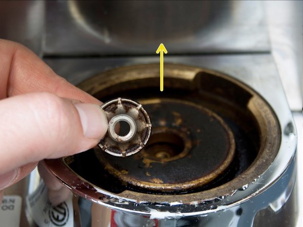

  5. Tune-up A Rancilio Silvia Espresso Machine, Deep Clean Grouphead Part A: crwdns2935265:05crwdnd2935265:01crwdnd2935265:03crwdne2935265:0 Tune-up A Rancilio Silvia Espresso Machine, Deep Clean Grouphead Part A: crwdns2935265:05crwdnd2935265:02crwdnd2935265:03crwdne2935265:0 Tune-up A Rancilio Silvia Espresso Machine, Deep Clean Grouphead Part A: crwdns2935265:05crwdnd2935265:03crwdnd2935265:03crwdne2935265:0
    • Soak this dirty little guy in coffee detergent with hot water. Then clean it again with a wire brush if needed.
    • Make sure to clean out all the water channels on the back side of the diffuser.

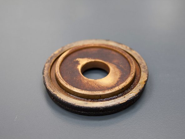

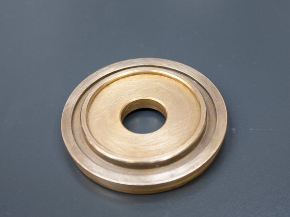

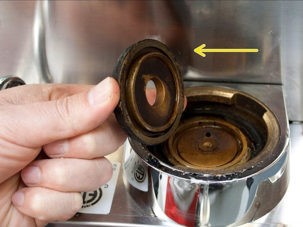

    • On Version 3 you will need to remove the brass disc. Just lift it out. If it is stuck you can use a channel lock pliers to get it loose. Be gentle! Careful not to damage the brass. You cannot remove the brass disk on Version 1 & 2
    • This is the brass disc after it is been removed. Soak it in coffee cleaner with hot water for about 10 minutes. Then, scrub both sides with a steel brush. Get leftover coffee residue off disc.

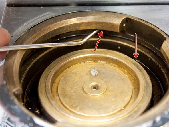

    • Picture of grouphead with brass disc removed on Version 3.

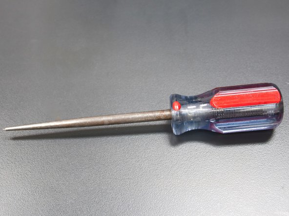

    • An awl works great for removing grouphead gaskets from espresso machines.
    • Pry the gasket up with the sharp tip of the awl.
    • Patience! You don't want to stab or poke yourself.

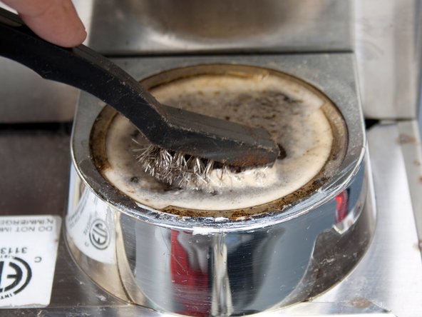

    • It's time to clean the bottom of the grouphead.
    • We like to pour about a 1/2 tsp of coffee cleaner on the bottom of the grouphead.
  8. Tune-up A Rancilio Silvia Espresso Machine, Soaking Grouphead with Coffee Cleaner: crwdns2935265:08crwdnd2935265:01crwdnd2935265:03crwdne2935265:0 Tune-up A Rancilio Silvia Espresso Machine, Soaking Grouphead with Coffee Cleaner: crwdns2935265:08crwdnd2935265:02crwdnd2935265:03crwdne2935265:0 Tune-up A Rancilio Silvia Espresso Machine, Soaking Grouphead with Coffee Cleaner: crwdns2935265:08crwdnd2935265:03crwdnd2935265:03crwdne2935265:0
    • Pour boiling hot water on the grouphead and let it soak for about 10 minutes.

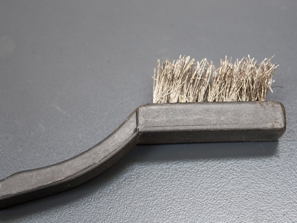

    • Take a wire brush like the one in the picture. Scrub the top of the grouphead clean.
    • Take some paper towel and soak up the liquid in the grouphead. The grouphead doesn't need to be perfectly dry at this point.

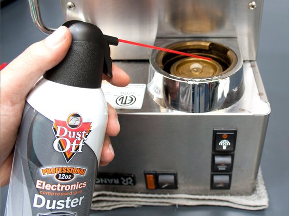

    • Use compressed air to remove all excess debris from the grouphead.

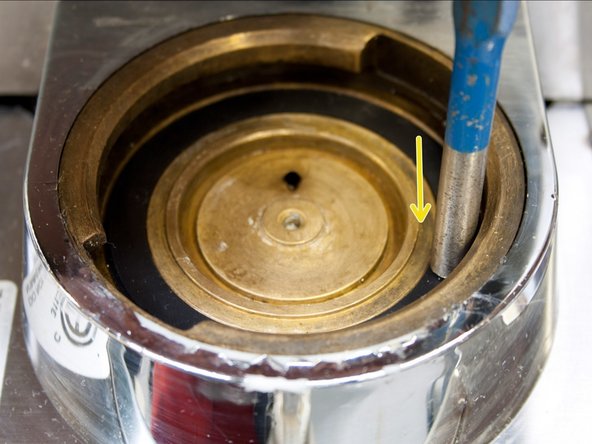

    • Get the New grouphead gasket.
    • Make sure it is a Rancilio Brand gasket. if it is an imitation it may not be exactly the right size. This could cause many problems.
    • Next with the lettering down insert the gasket into the grouphead. We use a 3/16" punch to gently push the gasket into place. Make sure the gasket is level on the entire surface.
    • If you have difficulty getting the gasket in or getting it level you may need to do a deeper cleaning of the grouphead.
    • if you have version 3 insert the brass disk you scrubbed earlier.

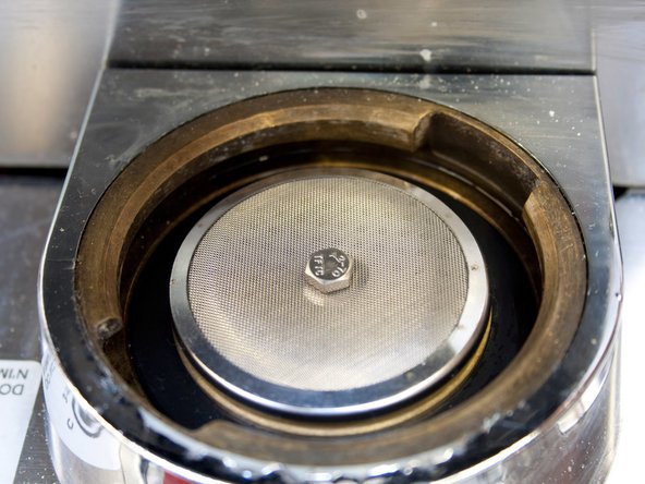

  11. Tune-up A Rancilio Silvia Espresso Machine, Replace Screen and Diffuser: crwdns2935265:011crwdnd2935265:01crwdnd2935265:03crwdne2935265:0 Tune-up A Rancilio Silvia Espresso Machine, Replace Screen and Diffuser: crwdns2935265:011crwdnd2935265:02crwdnd2935265:03crwdne2935265:0 Tune-up A Rancilio Silvia Espresso Machine, Replace Screen and Diffuser: crwdns2935265:011crwdnd2935265:03crwdnd2935265:03crwdne2935265:0
    • Then insert the stainless steel diffuser that you cleaned earlier.
    • The slotted side with the water channels should be facing down. Therefore, you will not be able to see the water channels when the diffuser is installed correctly.

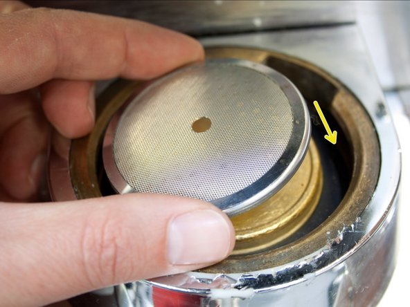

    • Install the new screen.
    • We highly recommend against using the old screen. It can be almost impossible to get perfectly clean because it has two layers.
    • Now put the screw in nice and tight. Use a 8mm socket wrench to do so. The screen should flex downward toward the grouphead when tightening the screw.
    • Congratulations! You have finished the repair.
