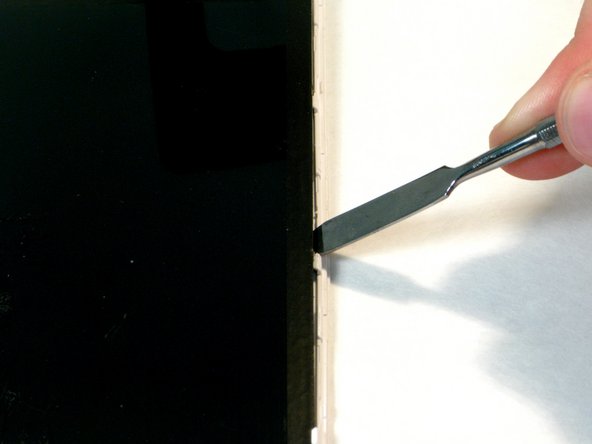

    • Starting near the middle edge of the Trio Stealth-G4X tablet, gently work an opening pick or spudger in between the seams of one side of the tablet.
  2. Trio Stealth-G4X Screen Replacement: crwdns2935265:02crwdnd2935265:01crwdnd2935265:01crwdne2935265:0
    • Work your way around all four corners of the tablet, unlocking all of the retaining tabs that hold the tablet together. This will allow you to separate the two halves of the tablet and access the motherboard.
    • Be sure not to over penetrate while separating the two halves as you may damage the tablet's internal hardware.

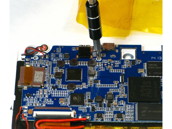

    • Peel back the yellow protective film on the motherboard to access the camera's ribbon cable.
  5. Trio Stealth-G4X Screen Replacement: crwdns2935265:05crwdnd2935265:01crwdnd2935265:01crwdne2935265:0
    • Take the Phillips head screwdriver and unscrew the 3mm screw right above the camera assembly. Place the screw aside so you do not lose it.

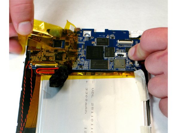

    • Slowly remove the yellow film covering the motherboard.
  11. Trio Stealth-G4X Screen Replacement: crwdns2935265:011crwdnd2935265:01crwdnd2935265:02crwdne2935265:0 Trio Stealth-G4X Screen Replacement: crwdns2935265:011crwdnd2935265:02crwdnd2935265:02crwdne2935265:0
    • Remove the three remaining 3 mm screws from the motherboard using a Phillips screwdriver.

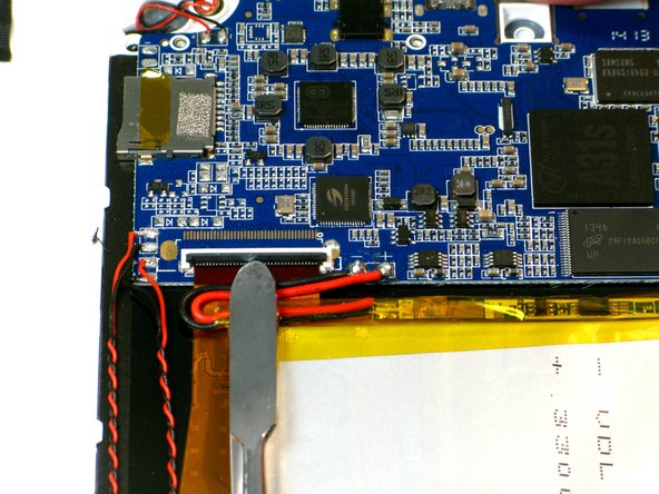

    • Locate the green wiring band at the bottom of the battery.
    • Although it has soldering points, you will not need to desolder the band for this replacement.
    • Very carefully use a spudger to peel the wiring band off of the battery pack.

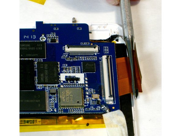

  13. Trio Stealth-G4X Screen Replacement: crwdns2935265:013crwdnd2935265:01crwdnd2935265:01crwdne2935265:0
    • Find the ribbon cable in the top right corner of the tablet.
    • This connects the digitizer to the motherboard.
    • Use a spudger to pry the black tab upwards, unlocking the ribbon cable connector.
  14. Trio Stealth-G4X Screen Replacement: crwdns2935265:014crwdnd2935265:01crwdnd2935265:02crwdne2935265:0 Trio Stealth-G4X Screen Replacement: crwdns2935265:014crwdnd2935265:02crwdnd2935265:02crwdne2935265:0
    • Use a spudger to lift the right side of the ribbon cable and disconnect it from the motherboard.
  15. Trio Stealth-G4X Screen Replacement: crwdns2935265:015crwdnd2935265:01crwdnd2935265:02crwdne2935265:0 Trio Stealth-G4X Screen Replacement: crwdns2935265:015crwdnd2935265:02crwdnd2935265:02crwdne2935265:0
    • Find the second ribbon cable near the top left corner of the tablet.
    • This connects the LCD screen display to the motherboard.
    • Use a spudger to pry the black tab upwards, disconnecting the ribbon cable.

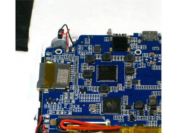

  16. Trio Stealth-G4X Screen Replacement: crwdns2935265:016crwdnd2935265:01crwdnd2935265:02crwdne2935265:0 Trio Stealth-G4X Screen Replacement: crwdns2935265:016crwdnd2935265:02crwdnd2935265:02crwdne2935265:0
    • Locate the microphone in the top left corner of the tablet. This piece easily pops our of the hole it is sitting in with the help of a spudger.
  17. Trio Stealth-G4X Screen Replacement: crwdns2935265:017crwdnd2935265:01crwdnd2935265:02crwdne2935265:0 Trio Stealth-G4X Screen Replacement: crwdns2935265:017crwdnd2935265:02crwdnd2935265:02crwdne2935265:0

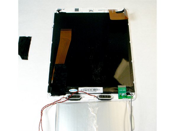

    • After all of these steps, the motherboard, speakers, and battery should all be able to be removed as one piece. The battery may have adhesive retaining it. To remove it work a pry tool underneath carefully separating it from the back of LCD screen.
    • Be careful when lifting all of these components out of the tablet.
  18. Trio Stealth-G4X Screen Replacement: crwdns2935265:018crwdnd2935265:01crwdnd2935265:02crwdne2935265:0 Trio Stealth-G4X Screen Replacement: crwdns2935265:018crwdnd2935265:02crwdnd2935265:02crwdne2935265:0

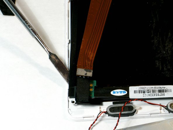

    • Next, gently work a spudger in between the screen and tablet in the top left corner. This starts to separate the adhesive holding the screen and tablet together.
    • Work your way down the left side of the tablet.
  19. Trio Stealth-G4X Screen Replacement: crwdns2935265:019crwdnd2935265:01crwdnd2935265:02crwdne2935265:0 Trio Stealth-G4X Screen Replacement: crwdns2935265:019crwdnd2935265:02crwdnd2935265:02crwdne2935265:0
    • Start in the top right corner of the tablet and use a spudger to work your way down the right side, further separating the screen and the tablet.
  20. Trio Stealth-G4X Screen Replacement: crwdns2935265:020crwdnd2935265:01crwdnd2935265:01crwdne2935265:0
    • The screen should now be able to be removed from the tablet.
    • Be sure to clean off any leftover adhesive from the tablet before installing the new screen. Re-installation and assembly can be done by following these steps in reverse order.
