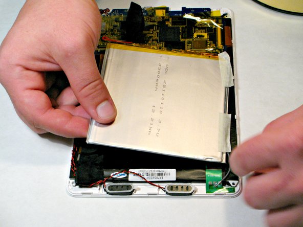

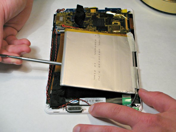

  8. Trio Stealth-G4X Battery Replacement: crwdns2935265:08crwdnd2935265:01crwdnd2935265:03crwdne2935265:0 Trio Stealth-G4X Battery Replacement: crwdns2935265:08crwdnd2935265:02crwdnd2935265:03crwdne2935265:0 Trio Stealth-G4X Battery Replacement: crwdns2935265:08crwdnd2935265:03crwdnd2935265:03crwdne2935265:0
    • There is a large amount of adhesive retaining the battery to the tablet. To remove the adhesive, gently work the pry tool under the battery pack.
    • Slowly continue this process until the battery is loose enough for you to grab with your hand.
    • Be gentle when prying the adhesive. If you use too much force, you can damage the LCD screen underneath it.
