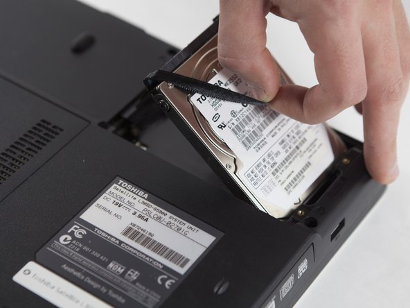

    • Power off your laptop before beginning disassembly.
    • Two 5.3 mm Phillips #1 screws boxed in red are located at the top right corner on the underside of the computer.
  2. Toshiba Satellite L305D-S5900 Storage Drive Replacement: crwdns2935265:02crwdnd2935265:01crwdnd2935265:03crwdne2935265:0 Toshiba Satellite L305D-S5900 Storage Drive Replacement: crwdns2935265:02crwdnd2935265:02crwdnd2935265:03crwdne2935265:0 Toshiba Satellite L305D-S5900 Storage Drive Replacement: crwdns2935265:02crwdnd2935265:03crwdnd2935265:03crwdne2935265:0
    • Remove the panel that houses the storage drive by unscrewing the two 5.3 mm Phillips #1 screws that hold it into place
  3. Toshiba Satellite L305D-S5900 Storage Drive Replacement: crwdns2935265:03crwdnd2935265:01crwdnd2935265:02crwdne2935265:0 Toshiba Satellite L305D-S5900 Storage Drive Replacement: crwdns2935265:03crwdnd2935265:02crwdnd2935265:02crwdne2935265:0
    • The standard hard disk drive that comes with this laptop model should have a ribbon attached to it. Pull this ribbon back until the hard drive comes out of the socket.
    • If your drive doesn’t have this ribbon, it can be pushed out of place by wedging a plastic opening tool in between the drive and its socket and push it out.
