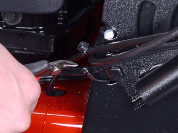

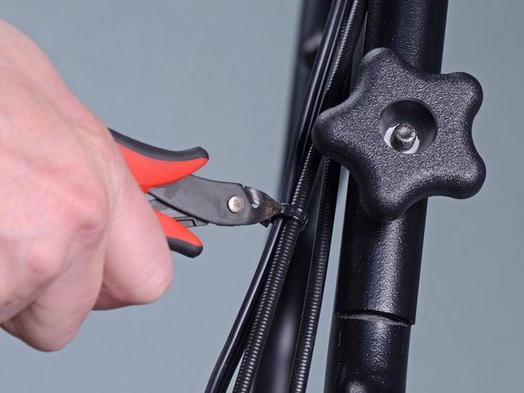

  5. Toro Walk Behind Mowers 21199HD 2018 Traction Cable Replacement, Cut the zip ties: crwdns2935265:05crwdnd2935265:01crwdnd2935265:02crwdne2935265:0 Toro Walk Behind Mowers 21199HD 2018 Traction Cable Replacement, Cut the zip ties: crwdns2935265:05crwdnd2935265:02crwdnd2935265:02crwdne2935265:0
    • Cut and remove the zip tie holding the cables together near the middle of the handle.
    • During reassembly, replace this zip tie.

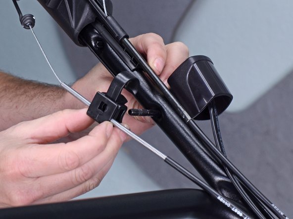

  6. Toro Walk Behind Mowers 21199HD 2018 Traction Cable Replacement: crwdns2935265:06crwdnd2935265:01crwdnd2935265:03crwdne2935265:0 Toro Walk Behind Mowers 21199HD 2018 Traction Cable Replacement: crwdns2935265:06crwdnd2935265:02crwdnd2935265:03crwdne2935265:0 Toro Walk Behind Mowers 21199HD 2018 Traction Cable Replacement: crwdns2935265:06crwdnd2935265:03crwdnd2935265:03crwdne2935265:0
    • Cut and remove the zip tie holding the cables together near the base of the handle.

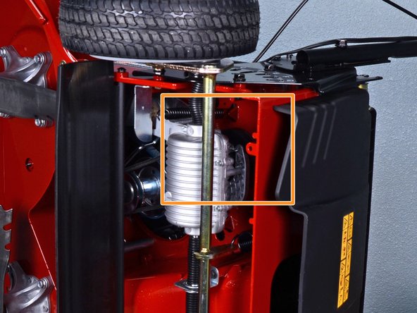

  7. Toro Walk Behind Mowers 21199HD 2018 Traction Cable Replacement, Find the end of the traction cable: crwdns2935265:07crwdnd2935265:01crwdnd2935265:03crwdne2935265:0 Toro Walk Behind Mowers 21199HD 2018 Traction Cable Replacement, Find the end of the traction cable: crwdns2935265:07crwdnd2935265:02crwdnd2935265:03crwdne2935265:0 Toro Walk Behind Mowers 21199HD 2018 Traction Cable Replacement, Find the end of the traction cable: crwdns2935265:07crwdnd2935265:03crwdnd2935265:03crwdne2935265:0
    • Tilt the mower onto its side, propping the handle up with a block of wood.
    • Locate the end of the traction cable underneath the mower, attached to the transmission.
    • The end of the traction cable is attached to a silver spring, and they come out as one unit.

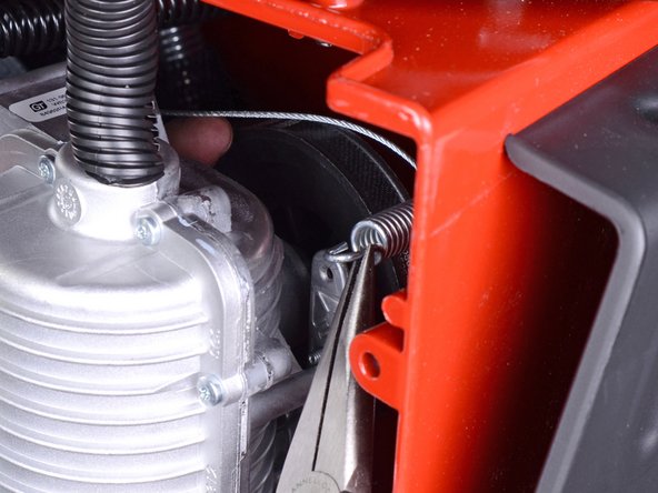

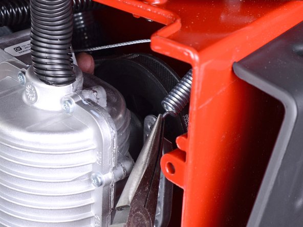

  8. Toro Walk Behind Mowers 21199HD 2018 Traction Cable Replacement, Unhook the traction cable spring: crwdns2935265:08crwdnd2935265:01crwdnd2935265:03crwdne2935265:0 Toro Walk Behind Mowers 21199HD 2018 Traction Cable Replacement, Unhook the traction cable spring: crwdns2935265:08crwdnd2935265:02crwdnd2935265:03crwdne2935265:0 Toro Walk Behind Mowers 21199HD 2018 Traction Cable Replacement, Unhook the traction cable spring: crwdns2935265:08crwdnd2935265:03crwdnd2935265:03crwdne2935265:0
    • Use a pair of needle nose pliers to unhook the traction cable spring from the transmission.

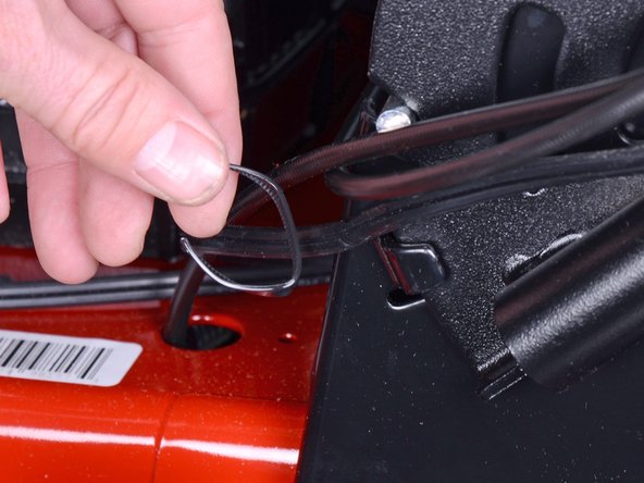

  10. Toro Walk Behind Mowers 21199HD 2018 Traction Cable Replacement, Remove the bottom end of the traction cable: crwdns2935265:010crwdnd2935265:01crwdnd2935265:02crwdne2935265:0 Toro Walk Behind Mowers 21199HD 2018 Traction Cable Replacement, Remove the bottom end of the traction cable: crwdns2935265:010crwdnd2935265:02crwdnd2935265:02crwdne2935265:0
    • Pull the traction cable out through the cutout in the frame.

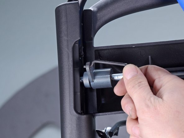

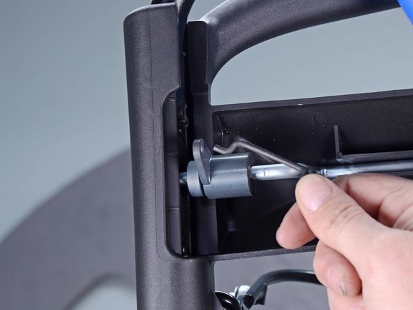

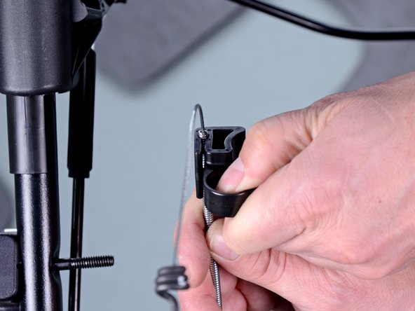

    • Unhook the traction cable handle lock.

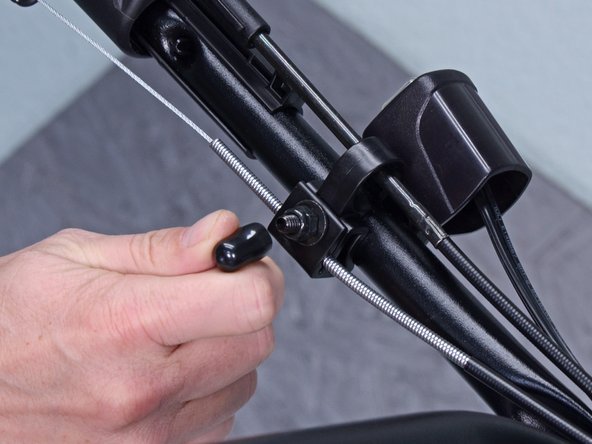

    • Remove the black silicone cap covering the nut on the switch and upper cable guide assembly.
  13. Toro Walk Behind Mowers 21199HD 2018 Traction Cable Replacement: crwdns2935265:013crwdnd2935265:01crwdnd2935265:01crwdne2935265:0
    • Use a 7/16 inch socket or wrench to remove the nut securing the kill switch and upper cable guide assembly.

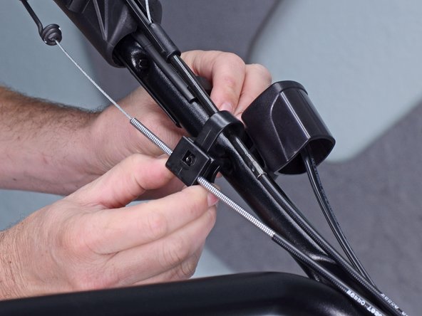

  14. Toro Walk Behind Mowers 21199HD 2018 Traction Cable Replacement: crwdns2935265:014crwdnd2935265:01crwdnd2935265:03crwdne2935265:0 Toro Walk Behind Mowers 21199HD 2018 Traction Cable Replacement: crwdns2935265:014crwdnd2935265:02crwdnd2935265:03crwdne2935265:0 Toro Walk Behind Mowers 21199HD 2018 Traction Cable Replacement: crwdns2935265:014crwdnd2935265:03crwdnd2935265:03crwdne2935265:0
    • Unclip and remove the upper cable guide from the handle.
    • Unroute the cables from the cable guide.
  15. Toro Walk Behind Mowers 21199HD 2018 Traction Cable Replacement: crwdns2935265:015crwdnd2935265:01crwdnd2935265:03crwdne2935265:0 Toro Walk Behind Mowers 21199HD 2018 Traction Cable Replacement: crwdns2935265:015crwdnd2935265:02crwdnd2935265:03crwdne2935265:0 Toro Walk Behind Mowers 21199HD 2018 Traction Cable Replacement: crwdns2935265:015crwdnd2935265:03crwdnd2935265:03crwdne2935265:0
    • Slide the metal cable tube out of the slot on the upper cable guide.
    • Remove the traction cable from the cable guide.
