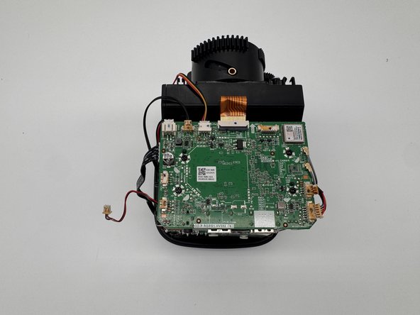

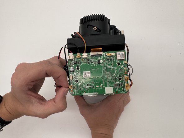

  2. Toptro TR23 Speaker Replacement, speaker: crwdns2935265:02crwdnd2935265:01crwdnd2935265:03crwdne2935265:0 Toptro TR23 Speaker Replacement, speaker: crwdns2935265:02crwdnd2935265:02crwdnd2935265:03crwdne2935265:0 Toptro TR23 Speaker Replacement, speaker: crwdns2935265:02crwdnd2935265:03crwdnd2935265:03crwdne2935265:0
    • Disconnect the motherboard speaker connector on the lower-left side of the motherboard.

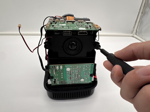

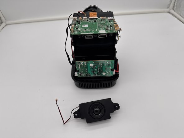

    • Remove the two 18.8 mm screws that secure the speaker to the Toptro TR23 with a Phillips #1 screwdriver.
    • Remove the speaker.
