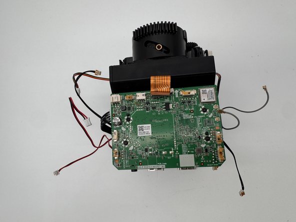

  2. Toptro TR23 Motherboard Replacement, Motherboard: crwdns2935265:02crwdnd2935265:01crwdnd2935265:03crwdne2935265:0 Toptro TR23 Motherboard Replacement, Motherboard: crwdns2935265:02crwdnd2935265:02crwdnd2935265:03crwdne2935265:0 Toptro TR23 Motherboard Replacement, Motherboard: crwdns2935265:02crwdnd2935265:03crwdnd2935265:03crwdne2935265:0
    • Use your fingernails to gently disconnect the six sliding connectors from their motherboard sockets.
    • Gently lift the two antenna cable connector to disconnect them.

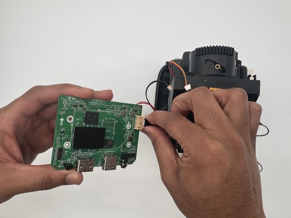

  3. Toptro TR23 Motherboard Replacement: crwdns2935265:03crwdnd2935265:01crwdnd2935265:03crwdne2935265:0 Toptro TR23 Motherboard Replacement: crwdns2935265:03crwdnd2935265:02crwdnd2935265:03crwdne2935265:0 Toptro TR23 Motherboard Replacement: crwdns2935265:03crwdnd2935265:03crwdnd2935265:03crwdne2935265:0
    • Flip up the black ZIF locking flap that secures the bronze ribbon cable.
    • Using your fingers carefully disconnect the ribbon cable.

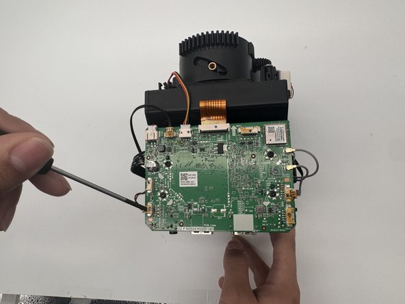

  4. Toptro TR23 Motherboard Replacement: crwdns2935265:04crwdnd2935265:01crwdnd2935265:03crwdne2935265:0 Toptro TR23 Motherboard Replacement: crwdns2935265:04crwdnd2935265:02crwdnd2935265:03crwdne2935265:0 Toptro TR23 Motherboard Replacement: crwdns2935265:04crwdnd2935265:03crwdnd2935265:03crwdne2935265:0
    • Use a Phillips #0 screwdriver to remove the four 7.3 mm screws securing the motherboard to the projector.

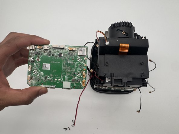

  5. Toptro TR23 Motherboard Replacement: crwdns2935265:05crwdnd2935265:01crwdnd2935265:03crwdne2935265:0 Toptro TR23 Motherboard Replacement: crwdns2935265:05crwdnd2935265:02crwdnd2935265:03crwdne2935265:0 Toptro TR23 Motherboard Replacement: crwdns2935265:05crwdnd2935265:03crwdnd2935265:03crwdne2935265:0
    • Gently lift the motherboard off to the left, with care not to strain the single remaining attached cable.
    • Disconnect the last connector from its motherboard scoket.
    • Remove the motherboard.
