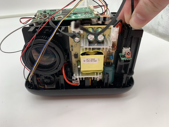

  6. TopTro TR25 Infrared Receiver Replacement: crwdns2935265:06crwdnd2935265:01crwdnd2935265:02crwdne2935265:0 TopTro TR25 Infrared Receiver Replacement: crwdns2935265:06crwdnd2935265:02crwdnd2935265:02crwdne2935265:0
    • Remove the case from the projector and set it aside.

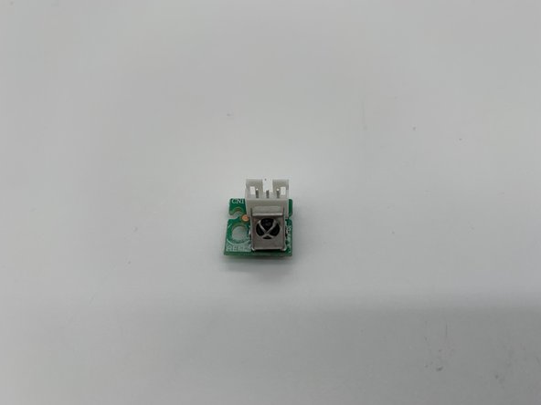

  7. TopTro TR25 Infrared Receiver Replacement, Infrared Receiver: crwdns2935265:07crwdnd2935265:01crwdnd2935265:03crwdne2935265:0 TopTro TR25 Infrared Receiver Replacement, Infrared Receiver: crwdns2935265:07crwdnd2935265:02crwdnd2935265:03crwdne2935265:0 TopTro TR25 Infrared Receiver Replacement, Infrared Receiver: crwdns2935265:07crwdnd2935265:03crwdnd2935265:03crwdne2935265:0
    • Use a Phillips screwdriver to remove the screws securing the IR receiver.
    • Remove the IR receiver.
    • The IR Receiver is small and fragile making it easily breakable
