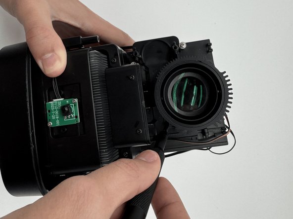

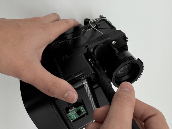

  4. TopTro TR23 Lens Replacement, Lens: crwdns2935265:04crwdnd2935265:01crwdnd2935265:02crwdne2935265:0 TopTro TR23 Lens Replacement, Lens: crwdns2935265:04crwdnd2935265:02crwdnd2935265:02crwdne2935265:0
    • Face the lens towards you.
    • Remove the four small black screws around the lens with a Phillips screwdriver.

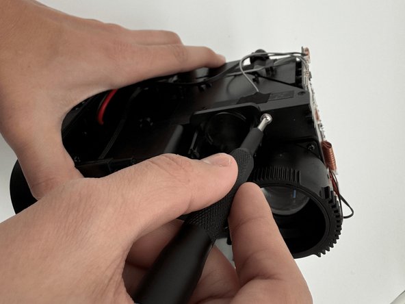

  5. TopTro TR23 Lens Replacement: crwdns2935265:05crwdnd2935265:01crwdnd2935265:03crwdne2935265:0 TopTro TR23 Lens Replacement: crwdns2935265:05crwdnd2935265:02crwdnd2935265:03crwdne2935265:0 TopTro TR23 Lens Replacement: crwdns2935265:05crwdnd2935265:03crwdnd2935265:03crwdne2935265:0
    • Remove the two silver screws with a Phillips screwdriver.
    • Remove the lens.
