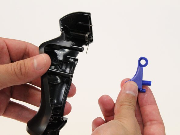

  2. Thrustmaster T Flight Hotas 4 Trigger Replacement, Trigger: crwdns2935265:02crwdnd2935265:01crwdnd2935265:03crwdne2935265:0 Thrustmaster T Flight Hotas 4 Trigger Replacement, Trigger: crwdns2935265:02crwdnd2935265:02crwdnd2935265:03crwdne2935265:0 Thrustmaster T Flight Hotas 4 Trigger Replacement, Trigger: crwdns2935265:02crwdnd2935265:03crwdnd2935265:03crwdne2935265:0
    • Carefully remove the paneling of the joystick using your hands to pull the panels apart.
    • Be aware that the panels will fall apart when the screws are removed unless they are held together.
    • This metal piece must be put back into its correct position. If not it will impair the movement of the joystick's rudder mechanism.
  3. Thrustmaster T Flight Hotas 4 Trigger Replacement: crwdns2935265:03crwdnd2935265:01crwdnd2935265:01crwdne2935265:0
    • Remove the 8 mm J1 JIS head screw that is holding the trigger in place.

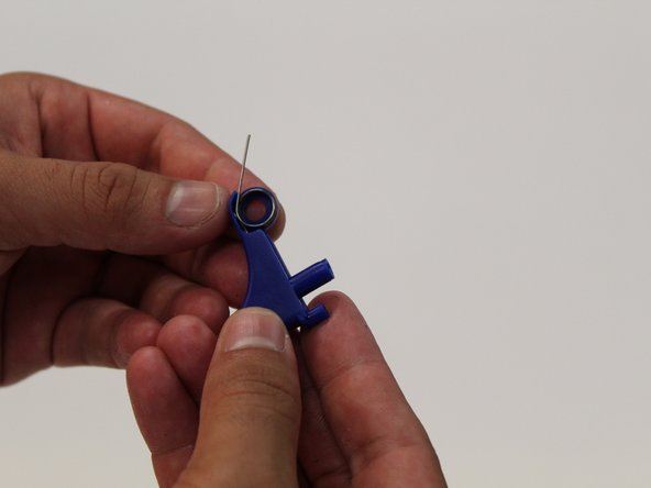

  4. Thrustmaster T Flight Hotas 4 Trigger Replacement: crwdns2935265:04crwdnd2935265:01crwdnd2935265:03crwdne2935265:0 Thrustmaster T Flight Hotas 4 Trigger Replacement: crwdns2935265:04crwdnd2935265:02crwdnd2935265:03crwdne2935265:0 Thrustmaster T Flight Hotas 4 Trigger Replacement: crwdns2935265:04crwdnd2935265:03crwdnd2935265:03crwdne2935265:0
    • Remove trigger and metal spring.
    • Remember to position the metal spring in the exact same place.
