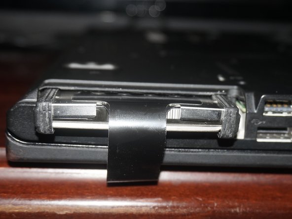

  6. ThinkPad T420 Hard Drive Replacement, Remove the hard drive caddy: crwdns2935265:06crwdnd2935265:01crwdnd2935265:03crwdne2935265:0 ThinkPad T420 Hard Drive Replacement, Remove the hard drive caddy: crwdns2935265:06crwdnd2935265:02crwdnd2935265:03crwdne2935265:0 ThinkPad T420 Hard Drive Replacement, Remove the hard drive caddy: crwdns2935265:06crwdnd2935265:03crwdnd2935265:03crwdne2935265:0
    • Pull the black tab on the drive caddy to remove the drive.
