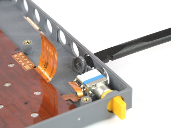

  12. Teenage Engineering OP-Z Function Key Plastic Buttons Replacement, Function Key Plastic Buttons: crwdns2935265:012crwdnd2935265:01crwdnd2935265:02crwdne2935265:0 Teenage Engineering OP-Z Function Key Plastic Buttons Replacement, Function Key Plastic Buttons: crwdns2935265:012crwdnd2935265:02crwdnd2935265:02crwdne2935265:0
    • Use a spudger to push the first set of function buttons inwards.
  13. Teenage Engineering OP-Z Function Key Plastic Buttons Replacement: crwdns2935265:013crwdnd2935265:01crwdnd2935265:01crwdne2935265:0
    • Remove the first set of function buttons.
    • This pair has a circular alignment post between the buttons and a dot mark on one of the buttons.

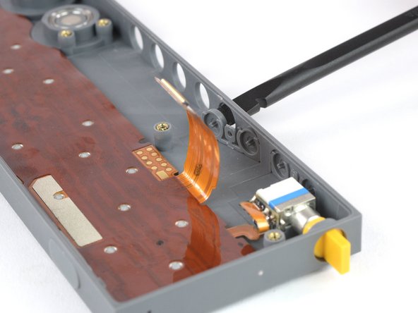

  14. Teenage Engineering OP-Z Function Key Plastic Buttons Replacement: crwdns2935265:014crwdnd2935265:01crwdnd2935265:02crwdne2935265:0 Teenage Engineering OP-Z Function Key Plastic Buttons Replacement: crwdns2935265:014crwdnd2935265:02crwdnd2935265:02crwdne2935265:0
    • Use a spudger to push the second set of function buttons inwards.
  15. Teenage Engineering OP-Z Function Key Plastic Buttons Replacement: crwdns2935265:015crwdnd2935265:01crwdnd2935265:01crwdne2935265:0
    • Remove the second set of function buttons.
    • This pair has an elliptical alignment post between the buttons and a straight mark on one of the buttons.
