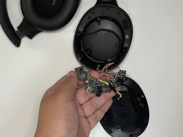

  3. TOZO HT2 Main Board Replacement, Main Board: crwdns2935265:03crwdnd2935265:01crwdnd2935265:01crwdne2935265:0
    • Use a Phillips screwdriver to remove each of the four screws on the speaker cover.
    • Lift the cover off without pulling on the wires inside and set it to the side to access the circuit board.
  4. TOZO HT2 Main Board Replacement: crwdns2935265:04crwdnd2935265:01crwdnd2935265:02crwdne2935265:0 TOZO HT2 Main Board Replacement: crwdns2935265:04crwdnd2935265:02crwdnd2935265:02crwdne2935265:0
    • Use a Philips screwdriver to remove the screws that secure the main board.
    • Carefully lift the board out of the headphones, making sure to not pull on and damage the wires inside.
  5. TOZO HT2 Main Board Replacement: crwdns2935265:05crwdnd2935265:01crwdnd2935265:01crwdne2935265:0
    • Use flush cutters to cut the wires as close as possible to their main board connections.
  6. TOZO HT2 Main Board Replacement: crwdns2935265:06crwdnd2935265:01crwdnd2935265:01crwdne2935265:0
