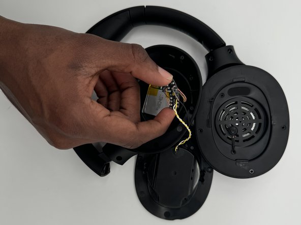

  3. TOZO HT2 Daughterboard Replacement, Daughterboard: crwdns2935265:03crwdnd2935265:01crwdnd2935265:01crwdne2935265:0
    • Use a Phillips screwdriver to remove all four screws that secure the right speaker cover.
    • Lift the cover off without pulling on the wires inside and set it to the side to access the circuit board.

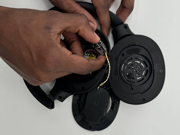

  4. TOZO HT2 Daughterboard Replacement: crwdns2935265:04crwdnd2935265:01crwdnd2935265:03crwdne2935265:0 TOZO HT2 Daughterboard Replacement: crwdns2935265:04crwdnd2935265:02crwdnd2935265:03crwdne2935265:0 TOZO HT2 Daughterboard Replacement: crwdns2935265:04crwdnd2935265:03crwdnd2935265:03crwdne2935265:0
    • Unscrew the circuit board and gently pull it up from the plastic tab it sits on.
  5. TOZO HT2 Daughterboard Replacement: crwdns2935265:05crwdnd2935265:01crwdnd2935265:01crwdne2935265:0
    • Carefully use flush cutters, to cut the wires connecting to the circuit board and the battery.
    • Be careful not to cut the wires too short. Ideally, as close to the circuit board and battery as possible removing minimal wire.
