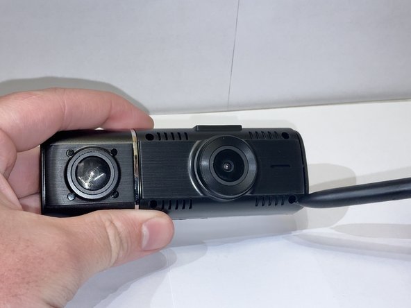

  1. TOGUARD C310 Dual Dash Cam Screen Replacement, Screen: crwdns2935265:01crwdnd2935265:01crwdnd2935265:02crwdne2935265:0 TOGUARD C310 Dual Dash Cam Screen Replacement, Screen: crwdns2935265:01crwdnd2935265:02crwdnd2935265:02crwdne2935265:0
    • Use a screwdriver to remove the four corner screws on the face of the dash cam.

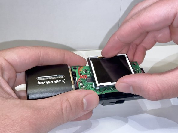

  2. TOGUARD C310 Dual Dash Cam Screen Replacement: crwdns2935265:02crwdnd2935265:01crwdnd2935265:02crwdne2935265:0 TOGUARD C310 Dual Dash Cam Screen Replacement: crwdns2935265:02crwdnd2935265:02crwdnd2935265:02crwdne2935265:0
    • Gently remove the cover from the screen.

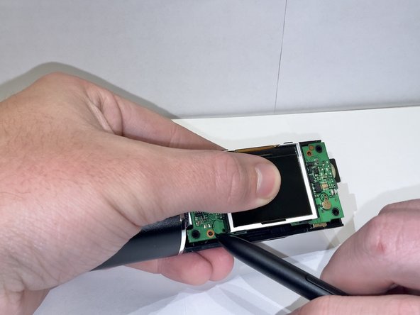

  3. TOGUARD C310 Dual Dash Cam Screen Replacement: crwdns2935265:03crwdnd2935265:01crwdnd2935265:02crwdne2935265:0 TOGUARD C310 Dual Dash Cam Screen Replacement: crwdns2935265:03crwdnd2935265:02crwdnd2935265:02crwdne2935265:0
    • Use a screwdriver to remove the two screws.

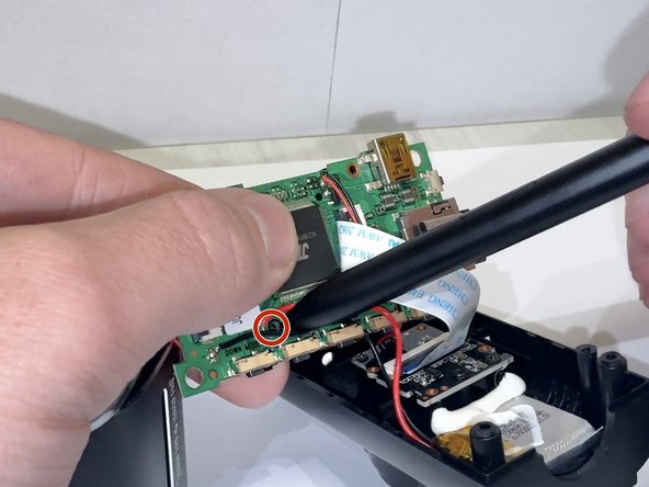

    • Turn over the motherboard and remove the two screws.
  5. TOGUARD C310 Dual Dash Cam Screen Replacement: crwdns2935265:05crwdnd2935265:01crwdnd2935265:01crwdne2935265:0
    • Disconnect the ribbon cable from the motherboard.
