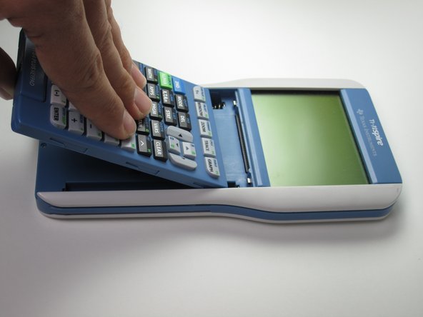

    4. TI-Nspire Battery Replacement: crwdns2935265:04crwdnd2935265:01crwdnd2935265:01crwdne2935265:0
      • Turn the calculator back to the front as you would normally use it.
    5. TI-Nspire Battery Replacement: crwdns2935265:05crwdnd2935265:01crwdnd2935265:02crwdne2935265:0 TI-Nspire Battery Replacement: crwdns2935265:05crwdnd2935265:02crwdnd2935265:02crwdne2935265:0
      • Put your hand on the keypad, slide the keypad down about a half inch, and pull up to remove the keypad.
    6. TI-Nspire Battery Replacement: crwdns2935265:06crwdnd2935265:01crwdnd2935265:01crwdne2935265:0
      • The batteries should be on the right and left side in the keypad area, with two on each side.
      • Place the tip of your finger in between the batteries, and remove the batteries. Repeat this for the other side as well.
    7. TI-Nspire Battery Replacement: crwdns2935265:07crwdnd2935265:01crwdnd2935265:01crwdne2935265:0
      • When reassembling your device, use four new batteries.
To reassemble your device, follow these instructions in reverse order. If your calculator doesn't turn on, it could be that the keypad isn't connected properly. If so, refer to Connecting the Keypad.
