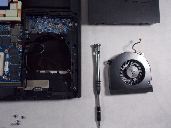

    3. System76 Serval WS Cooling Fan Replacement: crwdns2935265:03crwdnd2935265:01crwdnd2935265:01crwdne2935265:0
      • Unscrew and remove the screws circled in red, 3 screws per fan.
      • Next unplug the 4-pin power connectors, marked in orange squares.
      • Remove the cooling fans by lifting them up and out of the casing.
    4. System76 Serval WS Cooling Fan Replacement: crwdns2935265:04crwdnd2935265:01crwdnd2935265:02crwdne2935265:0 System76 Serval WS Cooling Fan Replacement: crwdns2935265:04crwdnd2935265:02crwdnd2935265:02crwdne2935265:0
      • Plug in the 4-pin power connectors of the new fans.
      • Insert and tighten 3 screws per fan.
      • If needed, clean off the old thermal paste from the CPU, GPU, and heatsink using isopropyl alcohol and a microfiber cloth. Apply new thermal paste before reassembly.
      • Clean the dust from the heatsink fins.
