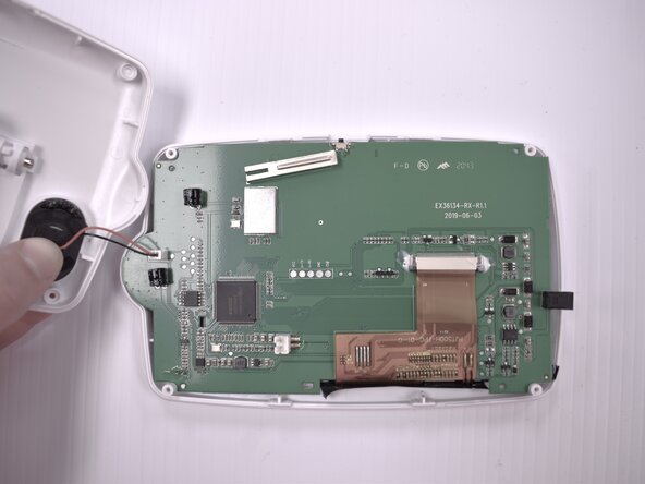

  3. Summer LookOut Duo Navigation Buttons Replacement, Motherboard and Display: crwdns2935265:03crwdnd2935265:01crwdnd2935265:03crwdne2935265:0 Summer LookOut Duo Navigation Buttons Replacement, Motherboard and Display: crwdns2935265:03crwdnd2935265:02crwdnd2935265:03crwdne2935265:0 Summer LookOut Duo Navigation Buttons Replacement, Motherboard and Display: crwdns2935265:03crwdnd2935265:03crwdnd2935265:03crwdne2935265:0
    • Using the Phillips #00 screwdriver, remove the four 7mm screws from each corner on the back of the handheld monitor.
    • Remove the casing from the back of the handheld monitor.
    • A nylon spudger may be helpful to pry the case open.

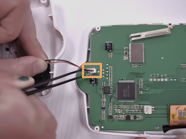

    • Using the angled tweezers, gently remove the plastic wire coupling connecting the speaker to the motherboard.
    • The power button may come loose as the case is being removed.

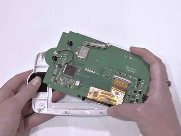

  4. Summer LookOut Duo Navigation Buttons Replacement: crwdns2935265:04crwdnd2935265:01crwdnd2935265:02crwdne2935265:0 Summer LookOut Duo Navigation Buttons Replacement: crwdns2935265:04crwdnd2935265:02crwdnd2935265:02crwdne2935265:0
    • Remove the motherboard and monitor display together and set aside.

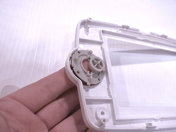

  5. Summer LookOut Duo Navigation Buttons Replacement, Navigation Buttons: crwdns2935265:05crwdnd2935265:01crwdnd2935265:02crwdne2935265:0 Summer LookOut Duo Navigation Buttons Replacement, Navigation Buttons: crwdns2935265:05crwdnd2935265:02crwdnd2935265:02crwdne2935265:0
    • Gently remove the black foam padding from the back of the buttons.
    • Using your fingers, gently lift the navigation buttons from the front monitor casing.
    • There are two sets of buttons: the outer navigation ring and the inner menu button.
    • The buttons are not fixed in place and will readily push out of the case. Use light force to prevent loss.
