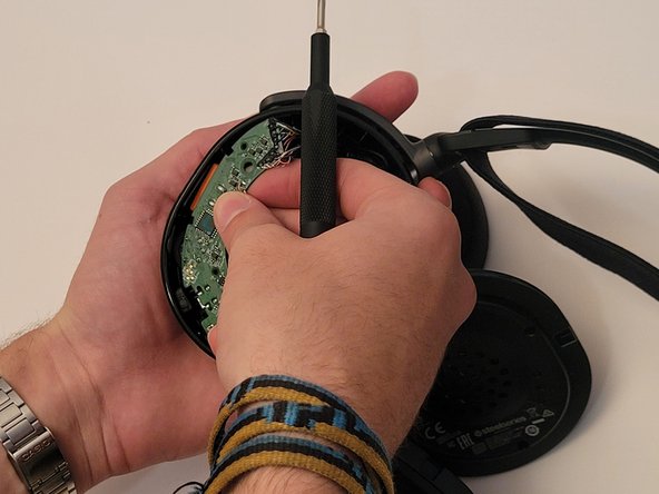

    • Remove the ear cushion on the left ear muff
    • This is done by pulling slightly on the outside of the cushion and moving around it until it comes off
  2. SteelSeries Arctis Pro Headset Volume Control Wheel Replacement: crwdns2935265:02crwdnd2935265:01crwdnd2935265:02crwdne2935265:0 SteelSeries Arctis Pro Headset Volume Control Wheel Replacement: crwdns2935265:02crwdnd2935265:02crwdnd2935265:02crwdne2935265:0
    • Remove the three 5mm screws with the Phillips #0 screwdriver head.
    • Separate the driver assembly from the rest of the housing
  3. SteelSeries Arctis Pro Headset Volume Control Wheel Replacement: crwdns2935265:03crwdnd2935265:01crwdnd2935265:02crwdne2935265:0 SteelSeries Arctis Pro Headset Volume Control Wheel Replacement: crwdns2935265:03crwdnd2935265:02crwdnd2935265:02crwdne2935265:0
    • Remove the 3 phillips #0 screws
    • Remove the circuit board by pushing the volume wheel in towards the center of the housing and pulling the board towards yourself
  4. SteelSeries Arctis Pro Headset Volume Control Wheel Replacement: crwdns2935265:04crwdnd2935265:01crwdnd2935265:03crwdne2935265:0 SteelSeries Arctis Pro Headset Volume Control Wheel Replacement: crwdns2935265:04crwdnd2935265:02crwdnd2935265:03crwdne2935265:0 SteelSeries Arctis Pro Headset Volume Control Wheel Replacement: crwdns2935265:04crwdnd2935265:03crwdnd2935265:03crwdne2935265:0
    • Remove the phillips #0 screw in the center of the headset volume wheel
    • Remove the wheel by pulling it upwards until it comes free
  5. SteelSeries Arctis Pro Headset Volume Control Wheel Replacement: crwdns2935265:05crwdnd2935265:01crwdnd2935265:01crwdne2935265:0
    • De-solder the five points on the back of the scroll wheel
Matthew Hockey

thanks for the tutorial
I have the equipment and skills to do this repair, but need to source parts.
Where would I get a replacement wheel and what would be the part #?
My wheel is starting to fail and as I adjust it, one earpiece cuts in and out. There is also a scratching/static sound as I turn the wheel
gloptum - crwdns2934203:0crwdne2934203:0
I am also searching for parts, Did you ever find some?
Michael McNamara -
A potential replacement is this part from digikey. I used it to fix my broken ChatMix wheel here: SteelSeries Arctis 7 2019 Edition Wireless CharMix Dial Potentiometer Replacement
