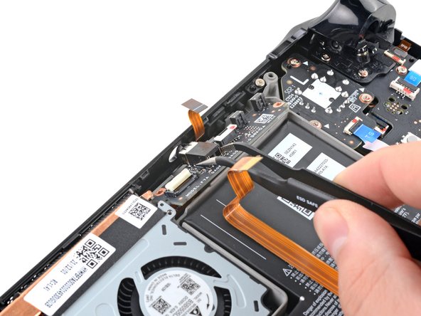

    4. Steam Deck Audio Board Replacement, Disconnect the battery: crwdns2935265:08crwdnd2935265:01crwdnd2935265:03crwdne2935265:0 Steam Deck Audio Board Replacement, Disconnect the battery: crwdns2935265:08crwdnd2935265:02crwdnd2935265:03crwdne2935265:0 Steam Deck Audio Board Replacement, Disconnect the battery: crwdns2935265:08crwdnd2935265:03crwdnd2935265:03crwdne2935265:0
      • Grip the battery cable by its pull tab and pull it directly away from the motherboard to disconnect it.
      • Alternatively, use the flat end of a spudger or a clean fingernail to gently push the connector out of its socket, then disconnect it completely by hand.

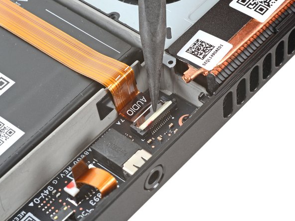

    1. Steam Deck Audio Board Replacement, Disconnect the audio cable: crwdns2935265:09crwdnd2935265:01crwdnd2935265:02crwdne2935265:0 Steam Deck Audio Board Replacement, Disconnect the audio cable: crwdns2935265:09crwdnd2935265:02crwdnd2935265:02crwdne2935265:0
      • Refreshed Steam Decks don't have this audio cable. If you have a refreshed version, skip the next two steps.
      • Use the pointed end of a spudger to lift up the small locking flap on the audio cable's ZIF connector.

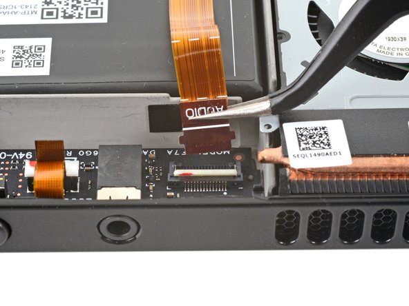

    2. Steam Deck Audio Board Replacement: crwdns2935265:010crwdnd2935265:01crwdnd2935265:02crwdne2935265:0 Steam Deck Audio Board Replacement: crwdns2935265:010crwdnd2935265:02crwdnd2935265:02crwdne2935265:0
      • Use a pair of tweezers to slide the cable out of its connector.
      • Grip the cable by its pull tab, not by the cable itself.

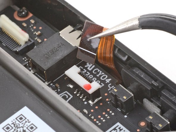

    3. Steam Deck Audio Board Replacement, Disconnect the mic cable: crwdns2935265:011crwdnd2935265:01crwdnd2935265:03crwdne2935265:0 Steam Deck Audio Board Replacement, Disconnect the mic cable: crwdns2935265:011crwdnd2935265:02crwdnd2935265:03crwdne2935265:0 Steam Deck Audio Board Replacement, Disconnect the mic cable: crwdns2935265:011crwdnd2935265:03crwdnd2935265:03crwdne2935265:0
      • Use a spudger to lift up on the mic cable's white locking tab.
      • You should feel a small tactile bump once the connector unlocks.
      • Use a pair of tweezers to pull the mic cable up and out of its connector.
      • With the connector properly unlocked, the mic cable should slide out with little to no resistance. If it doesn't immediately slide out, check that the white tab is fully unlocked.
      • During reassembly, ensure that the locking tab is in its unlocked, lifted position before reinserting the mic cable. Press down on the tab to lock the cable in place.
