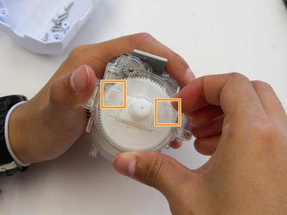

    • After you have removed the motherboard, use a JIS #1 screwdriver to remove the four 10mm screws holding in the cog shields.
    • Next, you want to pull apart the clips (two on each side) holding the top piece of the shield to the frame.
    • Then, once you have freed the cogs, you can lift the cog and remove it from the frame.

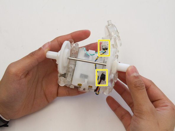

    • To completely remove the cog shield out of the way, carefully remove the black pin connectors from the slot in the shield.
    • Then, gently remove the wheels from the case
  7. Sphero Ollie Motor Replacement: crwdns2935265:07crwdnd2935265:01crwdnd2935265:01crwdne2935265:0
    • Once you have removed the cog out of the way, you can then pinch the clip on both sides to remove the cover protecting the battery

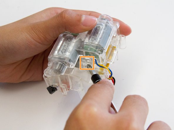

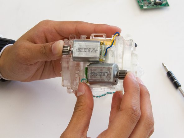

    • After you have removed the battery cover, flip the device around to view the motors
    • Loosen and use a JIS #1 screwdriver to remove the two 10mm Screws holding the clear case of the motors
    • Next, gently push the clip (on both sides) with a screwdriver to release the clear case
    • To remove the motors, simply pull on it with slight force
